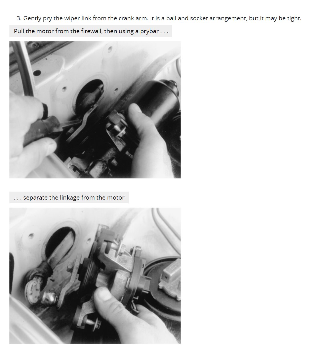

    Anyone know how to separate the wiper motor from the linkage? Does it just press on and off? I'm replacing the linkage assembly, the oem one is totally seized within the posts. I cannot get the bracket to separate from the wiper motor and I'm pretty positive it just presses in. Do I need a puller or am I doing something wrong?

    Thank you for the image and help. Now I'm confused though as the new linkage assembly has that piece attached to it already...I was trying to remove the last link from the motor itself.

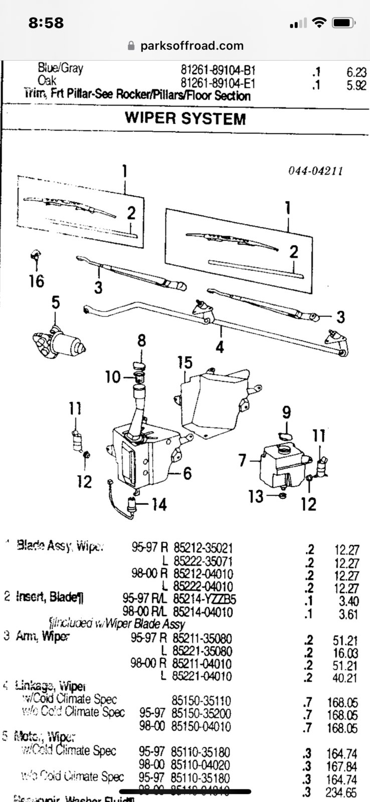

    I would be looking at part #4 (linkage)
    For bends/kinks/missing fasteners
    (Especially since you said sometimes only one arm works)
    This is my tacos microfiche 1996
    Possibly different from yours mind you
    Same premise thou
    Let everyone know what you find!
