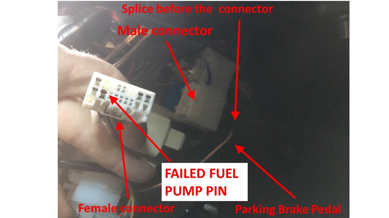

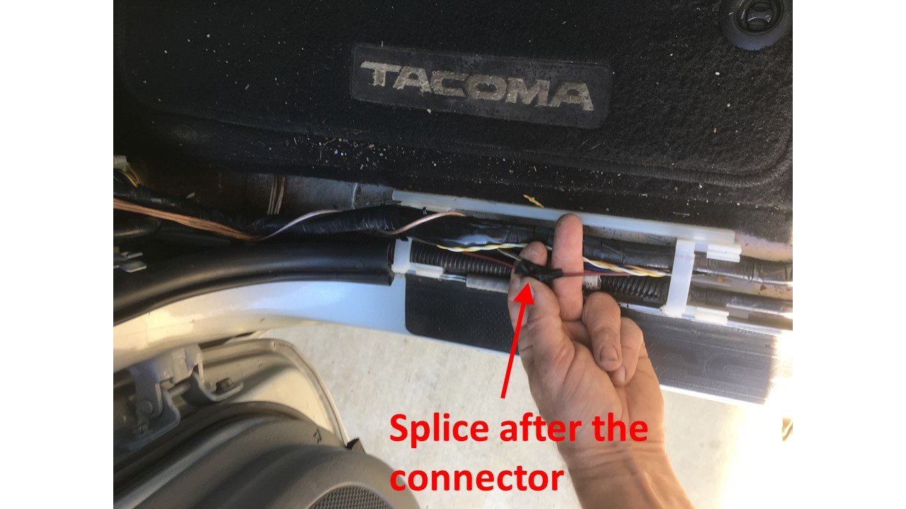

    PROBLEM SOLVED!!
    Yes, that's true: "Follow the red line in the schematic above." However, I found my problem to be not in the relays or breakers, or other aforementioned components, but at the cable harness connector that's on inside the cab right next to the parking brake. One of the connector pins lost contact, arced and burned out. So happens that this pin carried current to the fuel pump. . .At that, I ran a bypass from the wire section before the connector to a wire after the connector.
