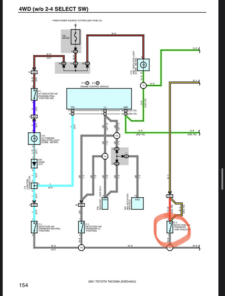

    Right on! Thanks for the quick reply’s. How would I go about testing the switch? I have a multimeter A8AD8CC2-A2BF-4C4F-AD82-096C2E07C86A.jpg
  13. Dec 26, 2020 at 10:06 AM
    Tdog2.7L
    Tdog2.7L [OP] Well-Known Member
    Oct 24, 2017
    #234029
    171
    2004 Tacoma 2.7l 4x4 & 2018 TRD Sport M/T
    Anyone have a 04 Tacoma wiring manual?
    Black97v6MT likes this.
  14. Dec 26, 2020 at 2:56 PM
    theesotericone
    theesotericone Well-Known Member
    Jul 27, 2018
    #260800
    12,382
    Bishop CA
    There's a plunger on the end of the switch that closes the circuit. When in 2wd it's open. When you shift into 4wd it's closed. Put it in 4wd and test for continuity. As stated, if 4L is working it's not a problem with the ADD system.
