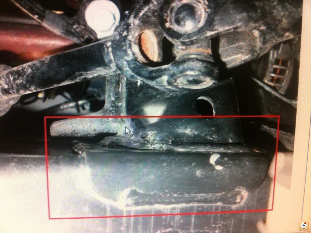

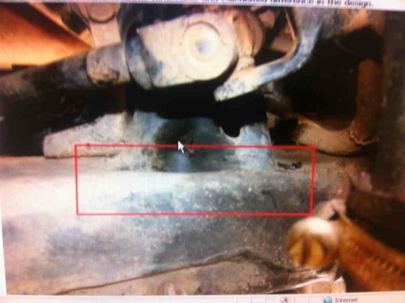

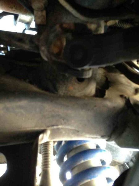

    Well I think I found the problem, my driver side engine mount gave out, the whole engine is resting On the alternator.. ImageUploadedByTapatalk1378575498.870707.jpg

    05's / 06's weak motor mounts
    07's and up Toyota realized there problem and changed them.

    That is the motor mount perch on the left side its cracked 3/4 the way around it and pushed in 1/2" or more.
    it was so difficult because the motor is laying in the truck all tweaked over to the left, resting on the alternator. The alternator may be functioning properly out of the truck, but its not charging the system.
    Tough to say why its not charging right now, we are thinking because its resting on the connector, its pushing it in a way that does not allow good solid contact on through the connector plug itself.
