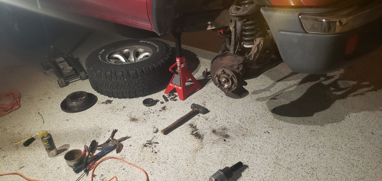

    P.S. I know the picture is of the passengers side, it was from when I replaced all the ball joints on the truck this weekend

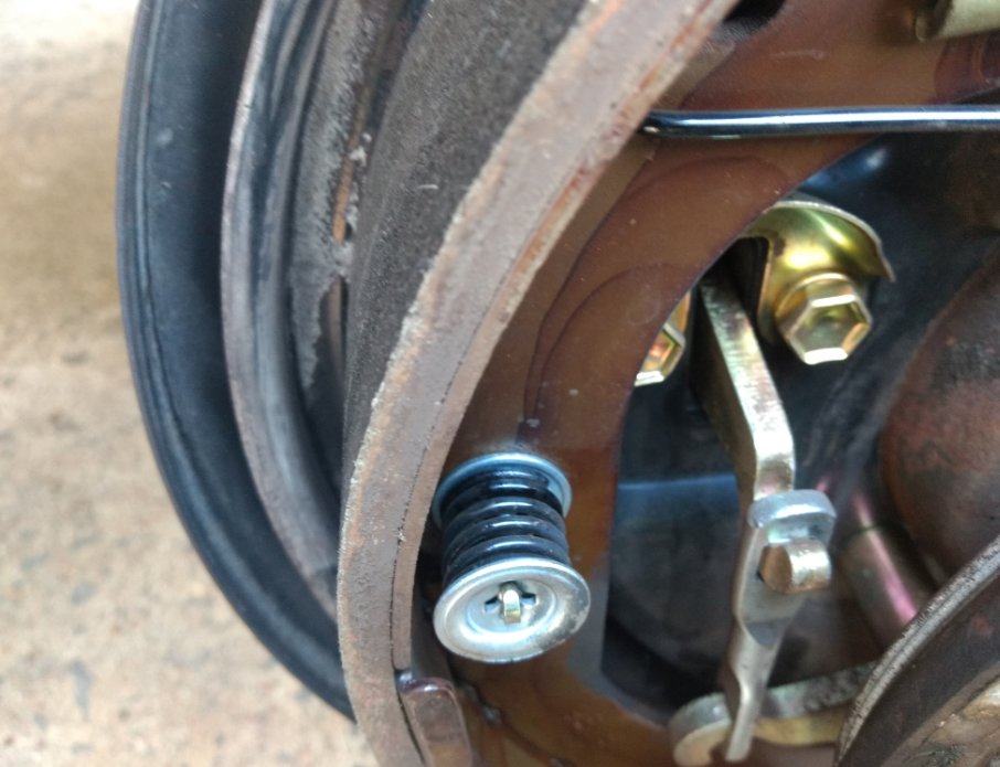

    The problem might be with the rear brakes.
    After refreshing my front brakes, and giving the brake system a thorough bleeding (proportion valve included), during staged lockup tests I had more pull to the left than I wanted. Even though the brakes were locked up, I did not want the truck to favor one side or the other.
    It turned out that adjusting the rear brakes had more to do with how the truck behaved during lockup than anything else.
    The rear brakes have plenty of shoe material. They just needed to be adjusted.

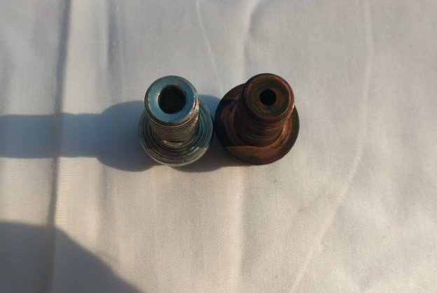

    Recently, I replaced BOTH calipers, pads, and rotors and found a substantial improvement in stopping power. The old brakes were not bad. They were just very old and I needed new lines. I thought the improvement was surprising especially since I used COTS brake pads and rotors. I believe the improvement in stopping power came from the new caliper's banjo bolt's larger bore size as shown in the picture below.
    I've seen members post about drilling out their OEM banjo bolts to improve brake fluid flow. I don't think I need to do that with these new banjo bolts.
