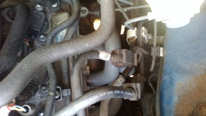

    Car alarm? I didn't think I had one except the key.... Anyways here starts the fun

    Update! Burnt wires on the wire harness.... What to do now? Buy a new harness and reroute???

    A bigger and more important question is what caused the burning wires?
    You need to Know what caused it and Fix that first.

    This for sure. It will happen again. Any over sized fuses being used?
    Which wires are burnt? At the starter?

    What caused it? URD headers touched them and burnt them according to my uncle. He says I might want to buy a new harness and put it on soon, he has new wire taped on, but there's not enough room to solder yet... How much $$$ do u think a new harness is, I am planning to reroute it...

    My guess would be the current trying to go to the starter? My uncle said I was lucky it was only the one wire burnt up...

    That is actually a fairly well known potential problem, when installing the headers. The wires have to be pushed out of the way, so as not to touch. Yours are now like that. Some protective heat shielding wire wrap or loom will also aid in protection from the heat.
    Ultimate key point here, is to be observant when making changes.
