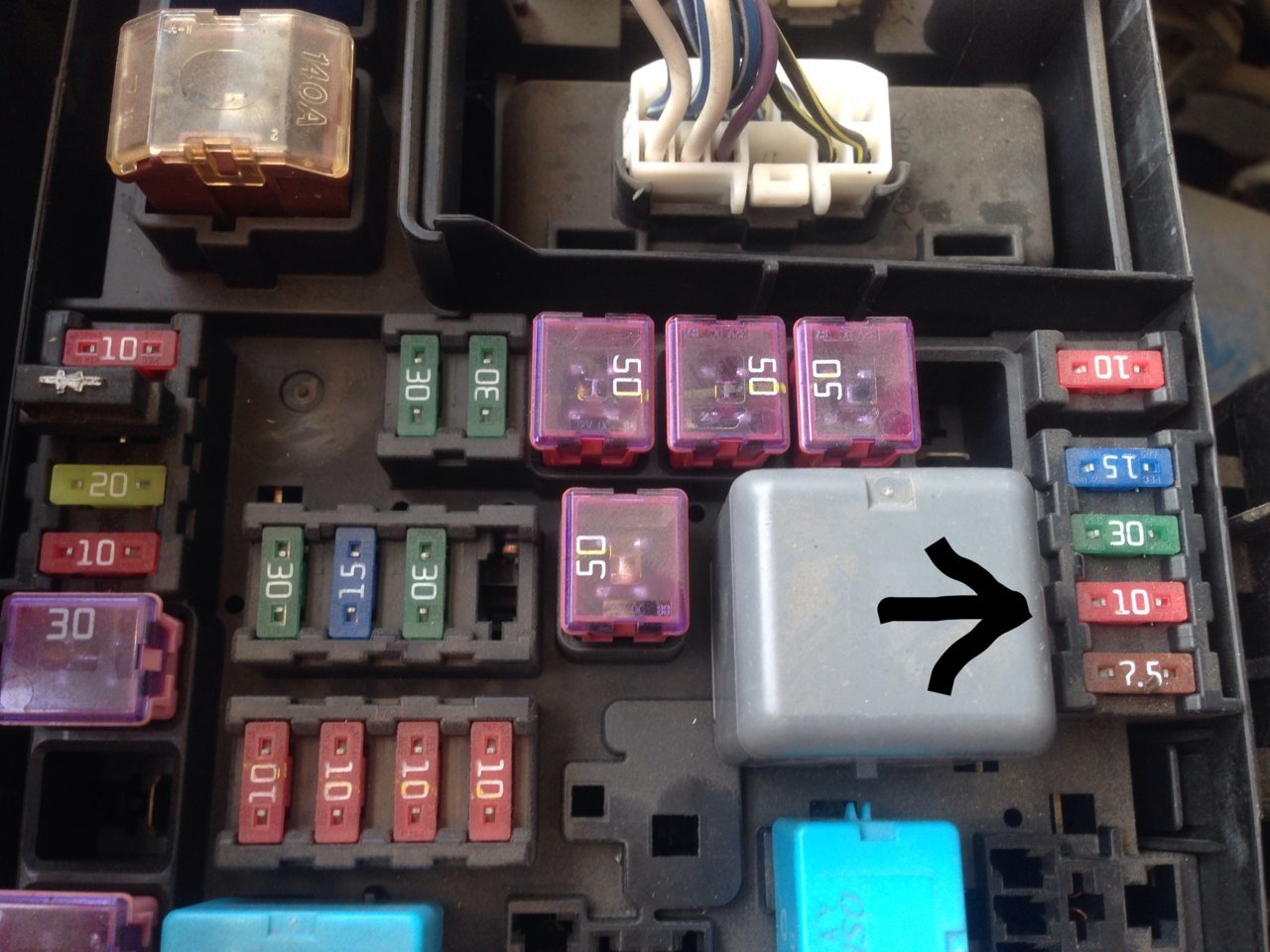

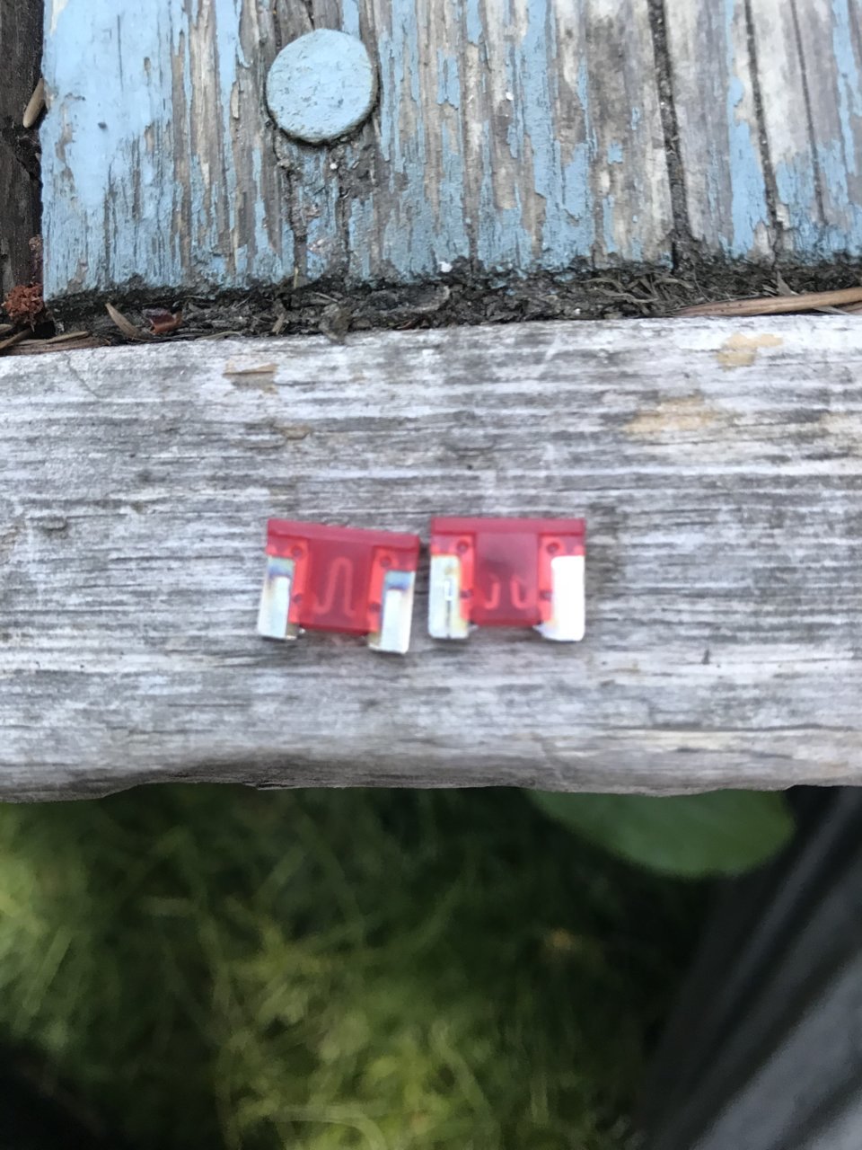

    There you go. As far as why it blew, that's going to be a tough one. 1st thing to look at is any aftermarket wiring. Remote start, topper 3rd brake light, tow lights that aren't factory.

    That was a very happy ending thank goodness.

    LOL, Muddin did everything but hit him over the head to check the fuse
