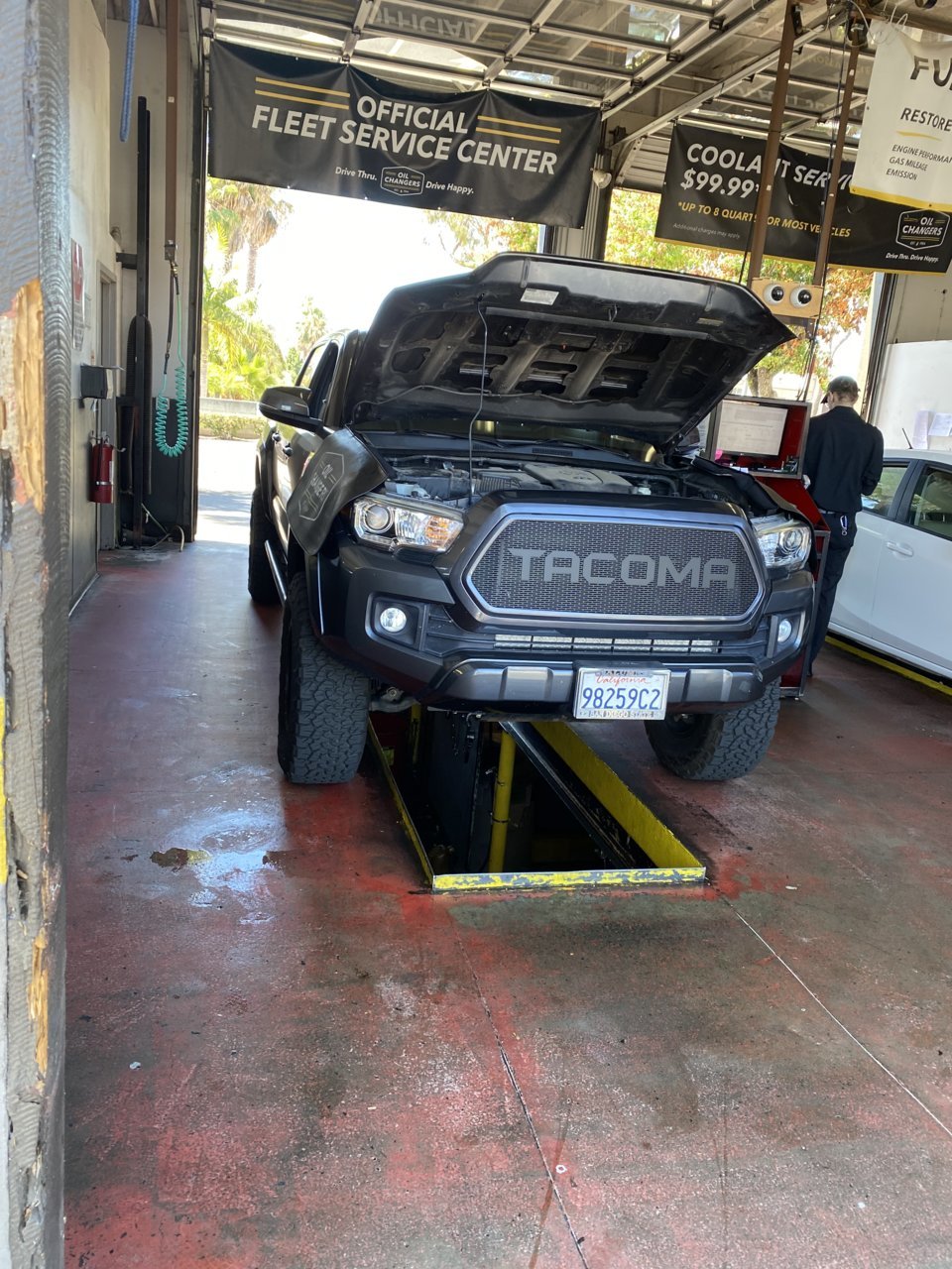

    I’m at the oil changer place….did a power steering pump flush, they washed down the engine bay, now the truck won’t start. Starter clicks….but won’t turn over. Tried jumping it so it’s not the battery….lights work.
    Thoughts? I’m stuck in the engine bay.

    #151688

    You could reach through the drivers side wheel well and give the starter a few love taps. Or just have it towed to a dealership and have them foot the bill for everything because they're the ones that caused this.

    Why did they wash down the engine bay?! Sounds like whoever washed it must of got water in the wrong places like the electrical components, starter and alternator.

    The engine cover sure looks dusty as hell for just being washed in that pic.
