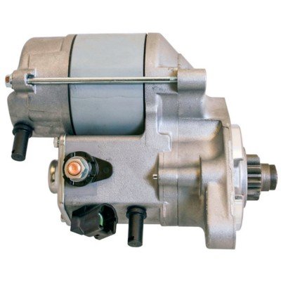

    Looked at many sources and if your starter looks like this one below the contacts should fit with no issues.

    Yup! Starter looks exactly like that. Gonna pull the trigger on the solenoid repair kit and test my luck. I'll keep you updated, I really appreciate the help!
