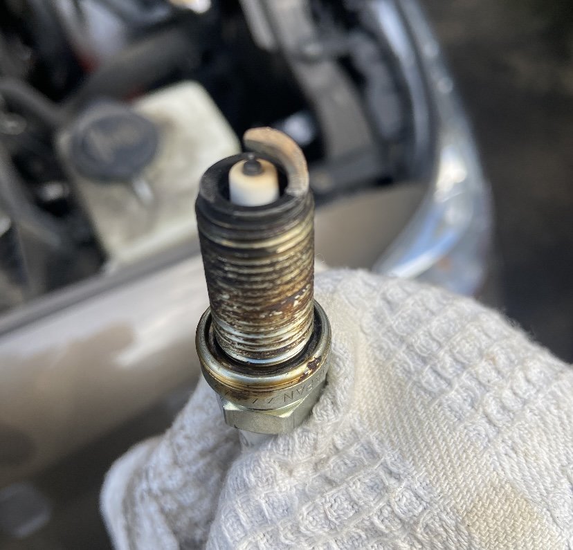

    Here was the dirtiest spark plug. It was the first plug I checked. As I kept going they started looking “cleaner.”

    Pop the #4 coil out (because it’s easiest to get to) and see if the tip is oil covered. If it is wet, slap new gaskets on it and I bet it will run like Jack the Bear. Plug looks ok. Double check the plugs are nice and snug.

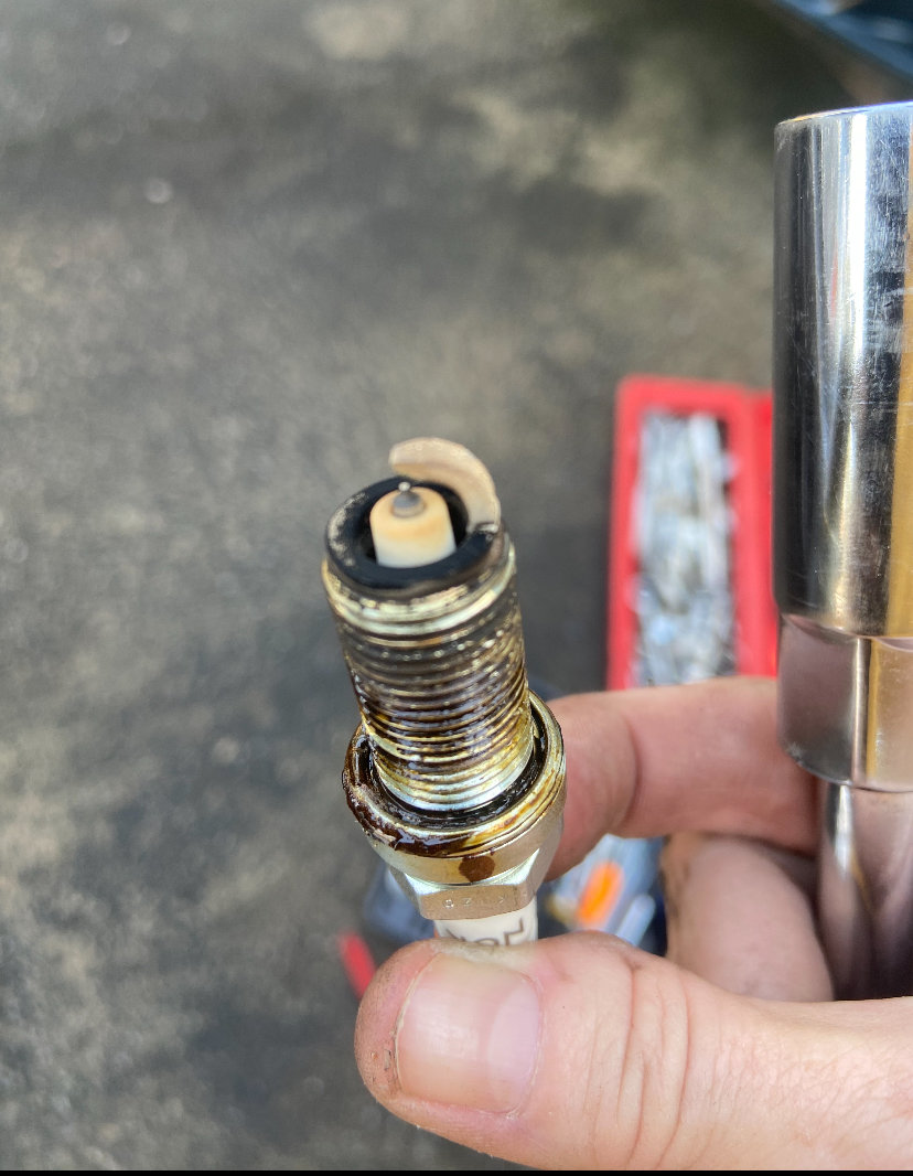

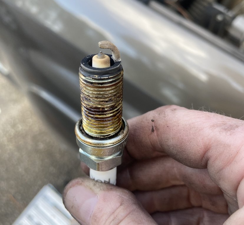

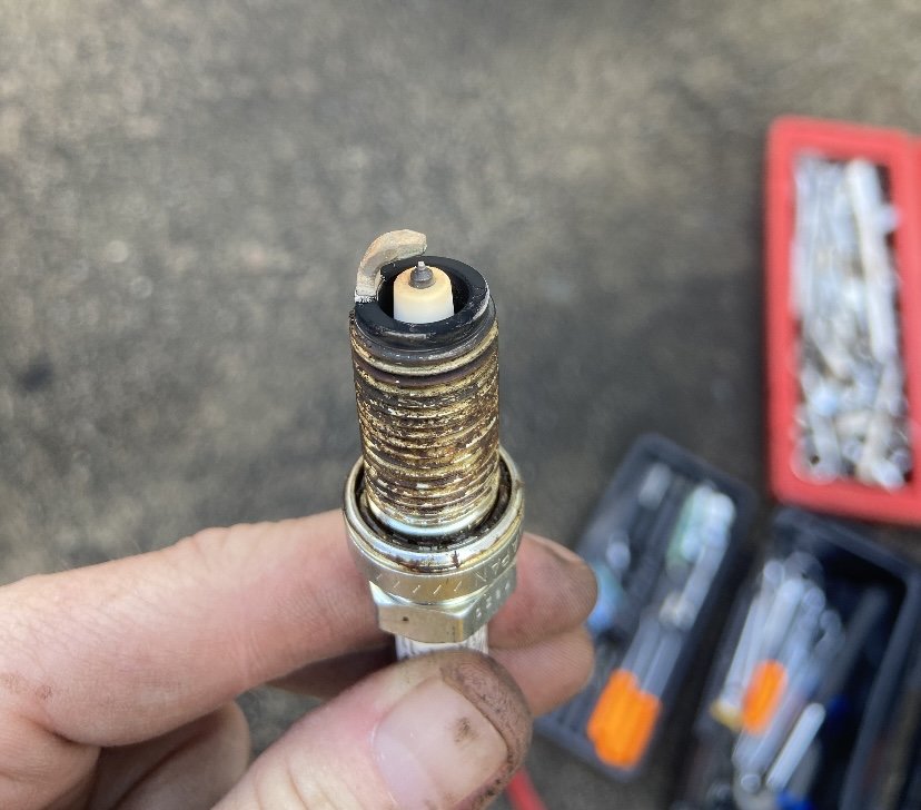

    Here are the rest of the plugs.

    Personally I’d replace the plugs; I don’t trust nuttin. When the truck is idling is the tachometer needle steady or does it bounce a little bit?
