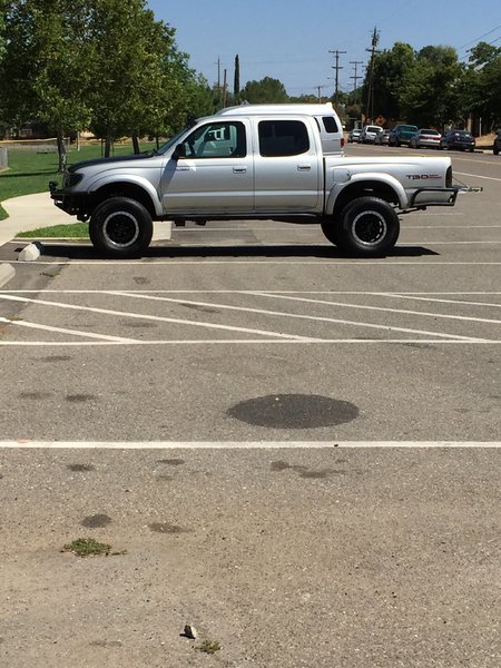

    Or save up enough for new leaf packs. I just don't want a raked truck. Right now I have 3" Eibach coils w/ adjustable 5100's on the bottom setting and Camburg UCA's. And in the back a 1.5" AAL. Here is how it sits now.

    Not mentioned but his leafs have very high mileage which is why i wouldnt bother with an aal. At this point they sag out a 2-3 inches and alot of times are deformed into a sort of "s" shape from axle wrap. Adding the aal will be more like a bandaid fix and probably just cancel out the sag.

    Tbh looking at the pic the leafs have probably been changed or thats not a true 1.5" aal.
    What about the current setup arent you happy with?

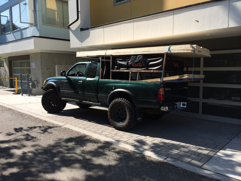

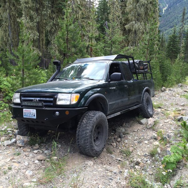

    image.jpg Mine were on the truck when I bought it 10+ years ago, like I said, they carry a lot of weight.
    Another thing to note, I've read some guys say that when they lift their Tacomas the axle is slightly rear of center, this was the case with the leafs I have, I had to relocate my axle forward about 3/4". It may be I have 2wd T100 springs, don't know, previous owner installed them to carry weight. May work better to just go with the pack with the centerline that is further forward
    And to verify some info others shared, rear leafs from an 89-95 Toyota 4wd truck will give a 95.5-97 Tacoma about 2" of lift and are a better spring over the stock Tacoma leafs which have a tendency to wear out and break the main leaf
