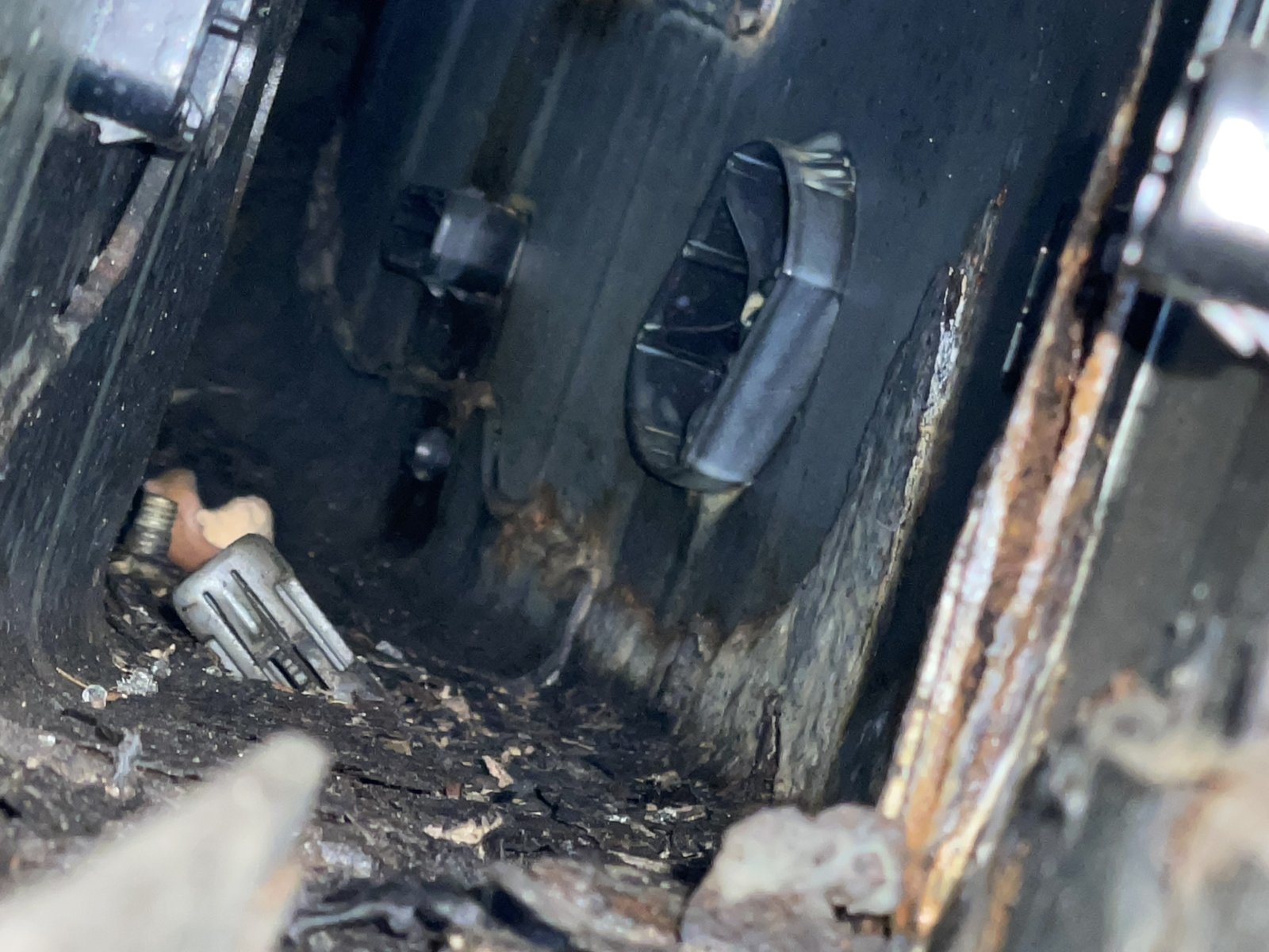

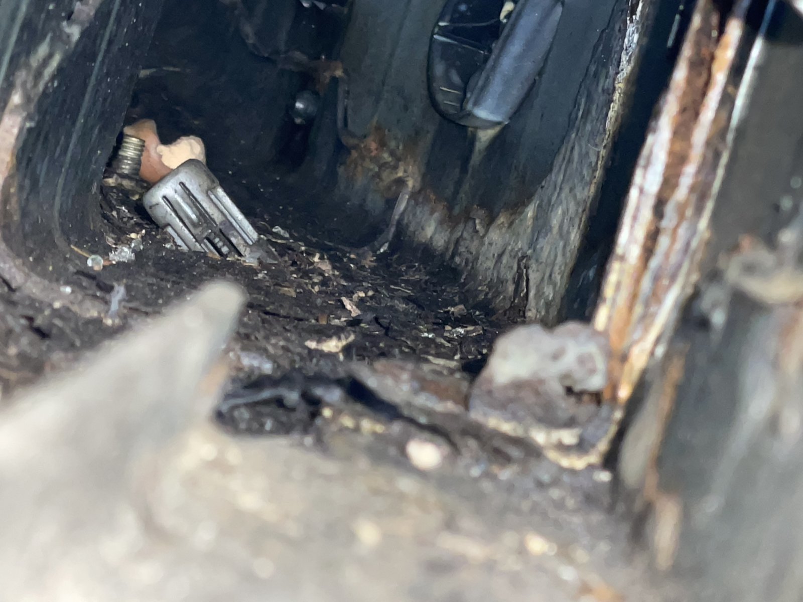

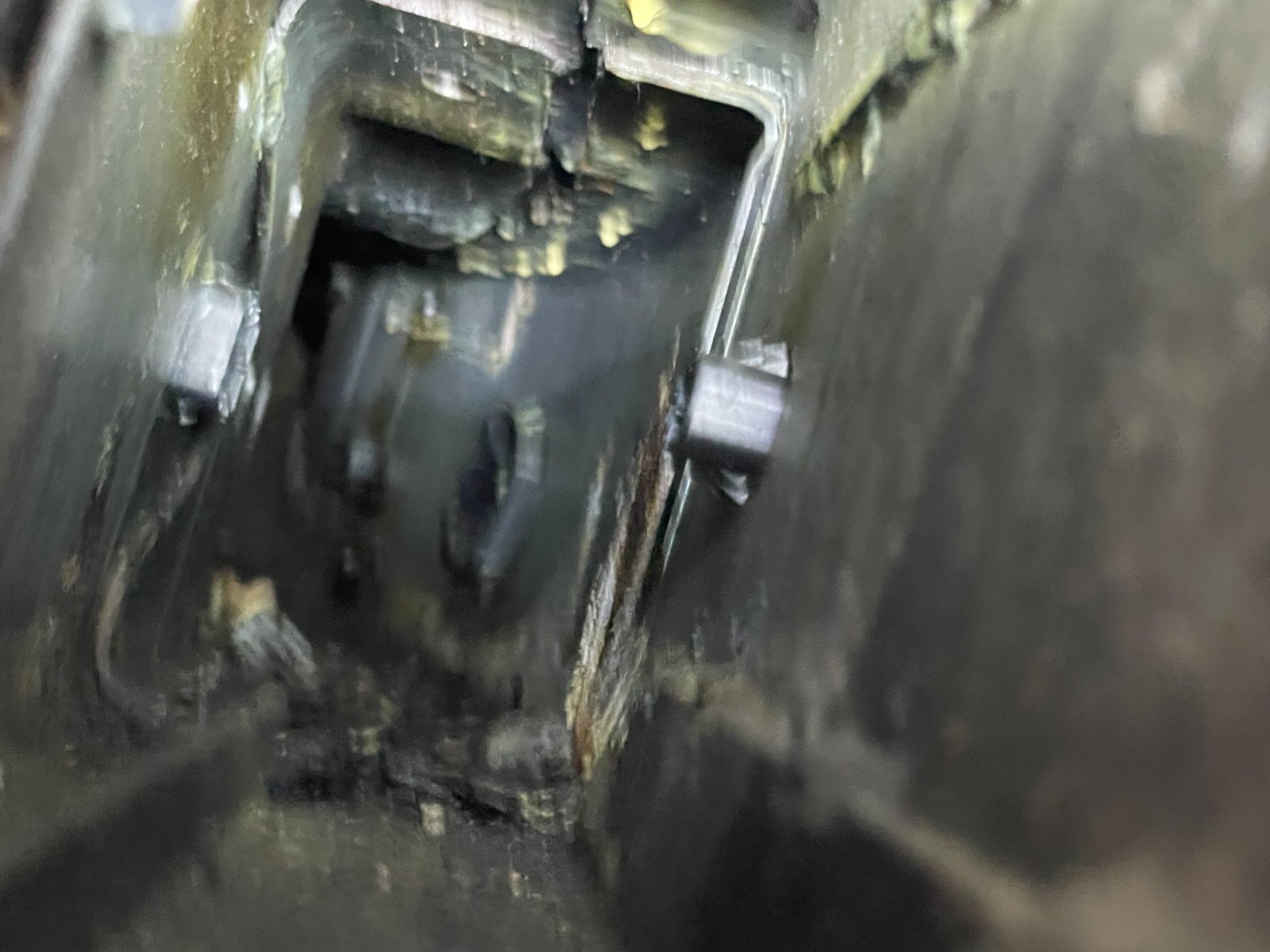

    hello again all, minor update. I had an appointment to have the truck inspected but there was an issue with the registration so I needed to postpone. I did take the time to try to get a good look at the Frame though. I had spoke to Toyota customer service prior and was told that the truck never completed its service campaign inspection when it was active. it did look like it had a coating of wax or cosmoline on the entirety of the frame so I couldn't see any real rust at all. it looks very solid with no swelling I could see. I did get a good look down the passenger box section from the passenger door going forward and it looks like there could be some rust in that section that may be concerning. it sounds solid when struck and has no soft spots on the outside but it may just be in the early stages. I wasn't able to see the drivers side since the brake lines are running up the opening. does anyone have an opinion on the rust seen in this section, good/bad/other, safe/fixable/run away? does anyone have a good phot of that area on a clean frame? thanks again in advance. IMG_6176.jpgIMG_6177.jpgIMG_6178.jpgIMG_6179.jpg

    That look really good IMO
    My frame rotted out in that area and currently replacing it
