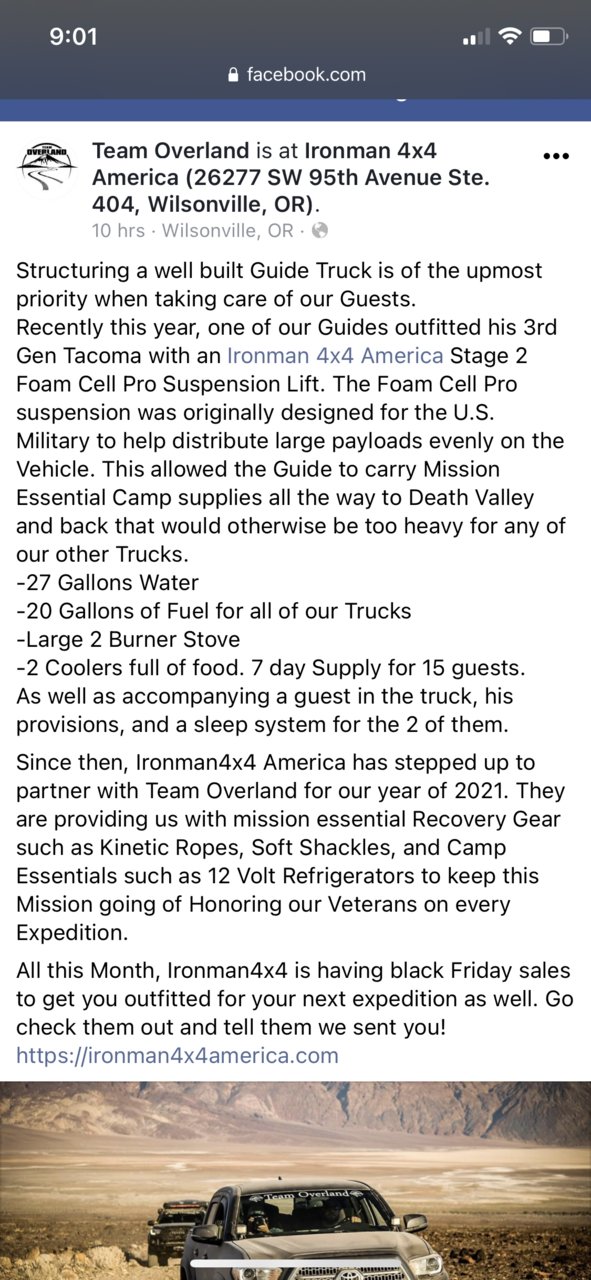

    Here is another cool thing about Ironman. been running my stage 2 FCP kit for 6 months and about 5k miles. Still quite happy with it. I’m a “weekend warrior” type and commute on a freeway during the week. I’m sure there are more comfortable options for the freeway portion. But off road, the suspension rocks. Truck feels solid and planted when traversing uneven ground. Washboard roads feel much better with the Ironman as well. FWIW I run 265/65/18 BFG KO2s. Going to move up to 265/70 or 275/70 in the next 6 months.

    For the 265/65/18 even stock I had no issues, I don’t think I’ll need the CMC for the 265/70/18s either, at least that is what I’ve been told.
    the commute is fine for me, it’s stiffer than stock, but not annoying. The best way to put it is that it makes the truck feel more stable and eliminates nose dive and body roll.
    Here is the screen shot of the FB post. Just gives a little more background on Ironman.
