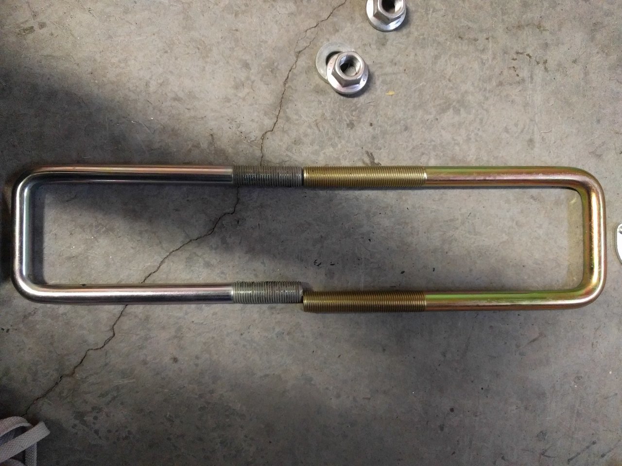

    Bought the Headstrong 3AAL leaf pack and it came with the wrong size u-bolts. The ones they sent are about a quarter inch too wide. I can almost get them on, but I need to really force it.
    What are the odds that a local auto parts store would have the right u-bolts in stock??
    IMG_20171110_150950.jpg Silver is the original, gold is the new one.

    The measurement is taken towards the top.

    Those look like the right ones...

    Put it in a vice and bend it in

    That is bent. Looks kinda obvious to me. Jk idk.
    But the original does look somewhat bent.

    It's you're sure they are wrong and you can't find them at a semi mechanic, OME and Rancho have u-bolts. Perhaps a 4Wheel Parts Wholesaler or other 4WD shop? There's nothing magically about U-bolts, find the right inside width and enough length, it's not rocket surgery.

    Lay them on top of each other and post another pic

    It's pretty unlikely that HS sent the wrong u bolts. They look pretty close to the original. The original looks slightly bent in. I've put on a bunch of u bolts over the years and very few went in without being squeezed in or pulled out a little.
    For the last question- you need an alignment after a lift anyway, but the pins and pads position the axle back on the same spot.

    Same as already posted, just bend it in a little - had to do the same on mine.

    Thats what I ended up having to do. It worked, but would have preferred them to fit correctly from the get go.

    They were correct, that's how u bolts are supposed to come, slightly out wards.

    I just had mine installed from HS yesterday too, yours look right. The shop that installed mine said they just cut off the extra length of ubolt to fit my single leaf kit and that they come that way. Also, what 3AAL kit did you get from HS? Mine was the single leaf Deaver 1.5” - 2” lift leaf, and it appears to have the same bolts as yours.
