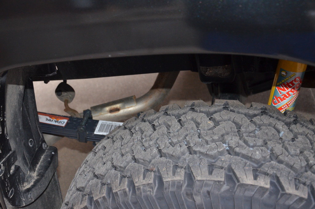

    Spring eye bushings...I have been using the three piece bushings, instead of the one piece. The one piece bushings are best installed with a good sized press, while the poly three piece can be assembled during install. A few years ago, I did ALL 16 bushings on my two old dodge trucks, a 62 Town Wagon and 68 Utiline pickup, with the procedure resolving into pulling springs one at a time, cutting the bolts with a die grinder and a 4" wheel, and pressing the old bushings out with a 20 ton press and custom tooling.
    Are the Toyota spring eye bushings the best out there right now? I have changed out my fair share of them, with a grinder, torch, press and press tooling to make the job go better.

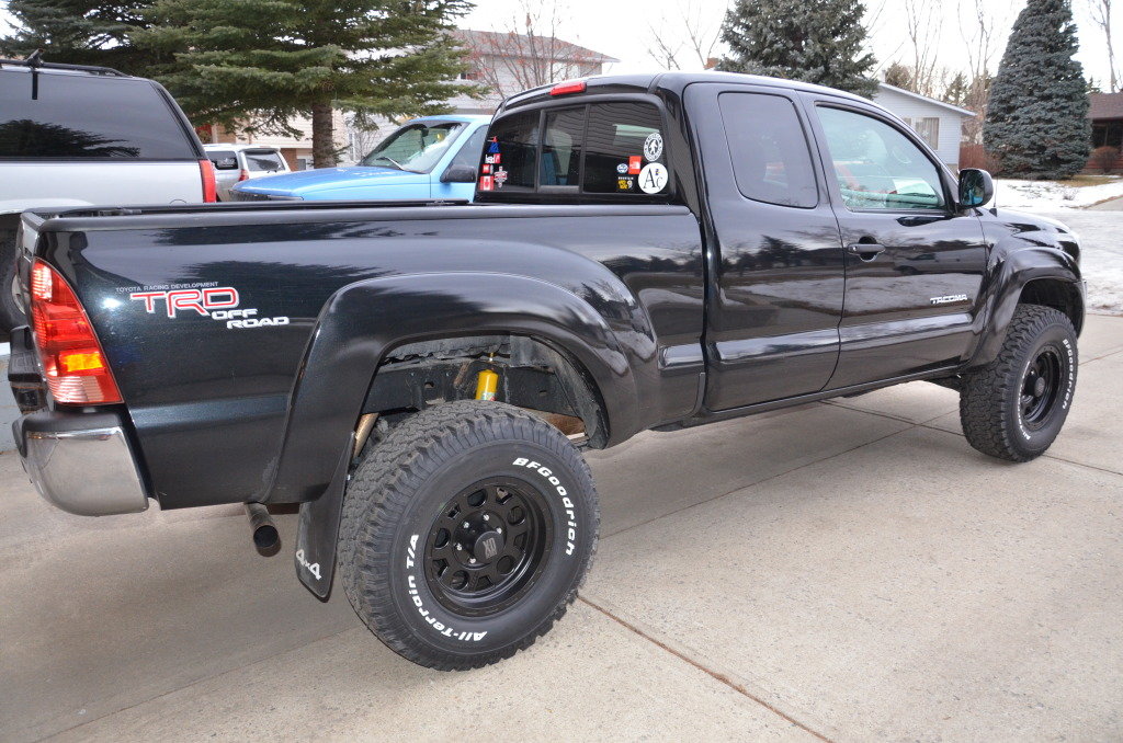

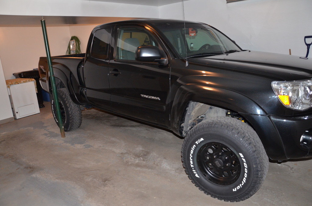

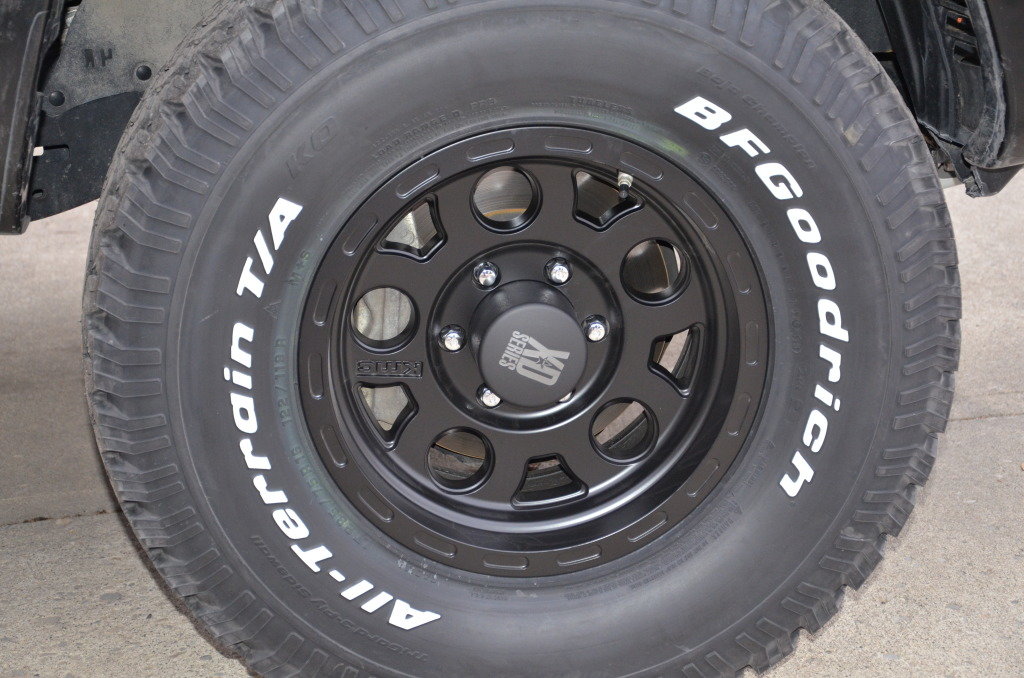

    Okay will make a build thread soon but thought I would give a preview with some pictures. Thanks all who helped with suggestions.
    Old Man Emu Suspension
    Went with the Dakar springs
    Also got the Light Racing UCA's
    BF Goodrich AT/KO and KMC Enduro rims

    Did you use top plate spacers with the 885's?

    No I do not have the top plate spacer and with the Dakar springs in the back I do have a pretty good rake. I am planning on getting a Thule rack on the back and hoping the springs settle a bit to give me a more level look. But love it regardless. Great ride and very pleased the way it turned out.

    sweet. you just sold me on this. ive been back and forth on bilstein and ome. any scrubbing issues with the 285's?

    Yeah I am not saying this because it was what I got but I love how it rides. I was scared that it would be different and it is but better. I really do like how it turned out. Just enough lift and awesome ride.
    As for the rubbing it does rub and I imagine the plate spacer might help a little bit with that. I trimmed a little in the front and took the front mudflaps off. Some say you can just trim the midflaps but thought what the heck just remove them. You can kind of see what I trimmed in the picture with just the tire and wheel. However I have not taken it out on the trail yet so I imagine there might be some more trimming involved.
    Good luck with whatever you choose but I think if you go with the OME kit you will NOT be disappointed.

    You can play with the arch on the rear springs to get your level back...any good spring shop can set the arch at any point you choose...I would go for about 1.5" LESS arch, the rubbing is from the front I suspect.
    I have built more leaf springs than I can count over the last 30 years...
