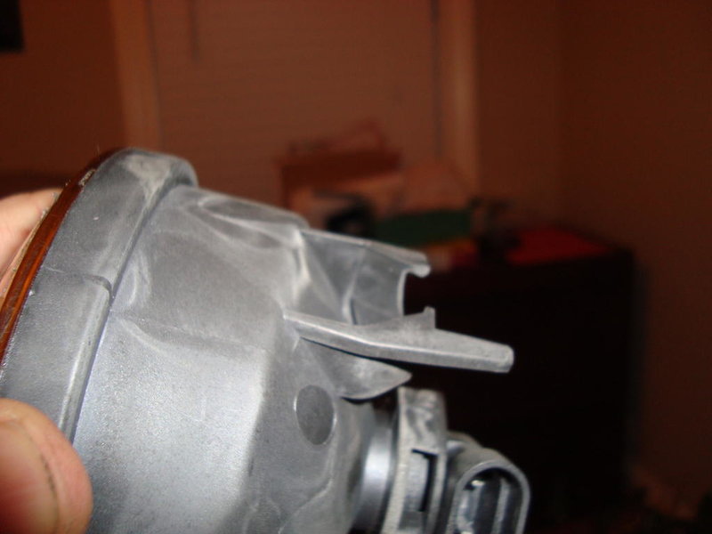

    I was trying to install my new yellow fog lights today, and when i was working on the passenger side, some how i broke a plastic part (due to the poor quality of the product) where the adjustment knob is located. Just bought them from ebay last wednesday. Not sure if they can replace it?ah, and the broken part is gone... I'll appreciate any ideas..thanks ..

    If you can find the piece that broke off, Go to Autozone or the like and get Plastic "Welding" kit. It looks like a syringe.
    Its plastic resin, Mix that together, set it, and let it dry for about 30 minutes- It'll be good as new and stronger than new

    ^^^^ Thanks buddy it helped a lot..I did it early this morning and it seems to be working...
