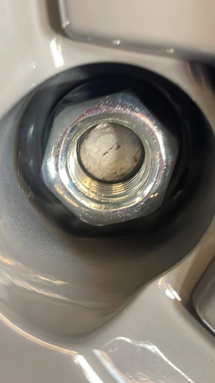

    New, I'm having issues with the installation of my new Black Rino wheels as they are offset and the OEM studs are too short to thread on the lug buts. Attached pictures of the wheels and issue with the wheel studs. Where can I find 1/2 inch longer wheel studs that will fit my tacoma? Anyone had this when installing new wheels?

    Nothing wrong with the studs, you need a 1.25ET lug. They reach in further into the lug hole in rim.

    You got to change your nuts Dude

    What's the link to get those lug nuts?

    Amazon.
