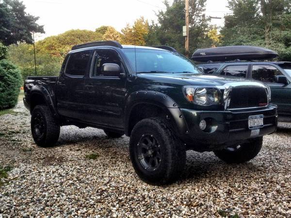

    I just joined the forum and could use some help. Just bought a 2010 tacoma trd 4x4 4door long box. I got a 3 inch toytec lift and bought some 285/75R16 mud tires. I've been trying to find a black daytona style rim and the ones I ordered don't have the right offset as the wheel hits the brake caliper on the front tires. The ones that I ordered where the Cragar 3977860P - Cragar Soft 8 Black Wheels. 16x8, 6x5.5inch bolt pattern with +13mm offset or 5 inch back spacing. Unfortunately they hit the brake caliper so I have to send them back.
    If anyone knows what amount of offset will work and if they're available in a similar style wheel I would be forever grateful!!!
    I've included 2 pictures:
    1) My truck on the hoist with the wrong sized wheel
    and
    2) A picture of a Tacoma I found on Tacoma World where I would love to know the dimensions of the wheel/tire/lift combination. Please contact me if this is your truck.
    Thanks and looking forward to some input so I can get out and get some wheeling done!
    Scott

    Almost all steel wheels hit the calipers of the 2nd gen tacomas. The first truck pictured looks like it has procomp alloys.

    OP here are some similar wheels:
    Wheelers steelies (the only steelies that clear the calipers)
    [​IMG] Pro Comp 7069

    Not the "wheels" you described BUT every other "spec" is the same; 3" lift and tire size...PLUS I have seen this truck in person.....Pictures do not do justice...;).....Lucky for me he upgraded like you because I purchased his TRD wheels/tire combo....:cool:
