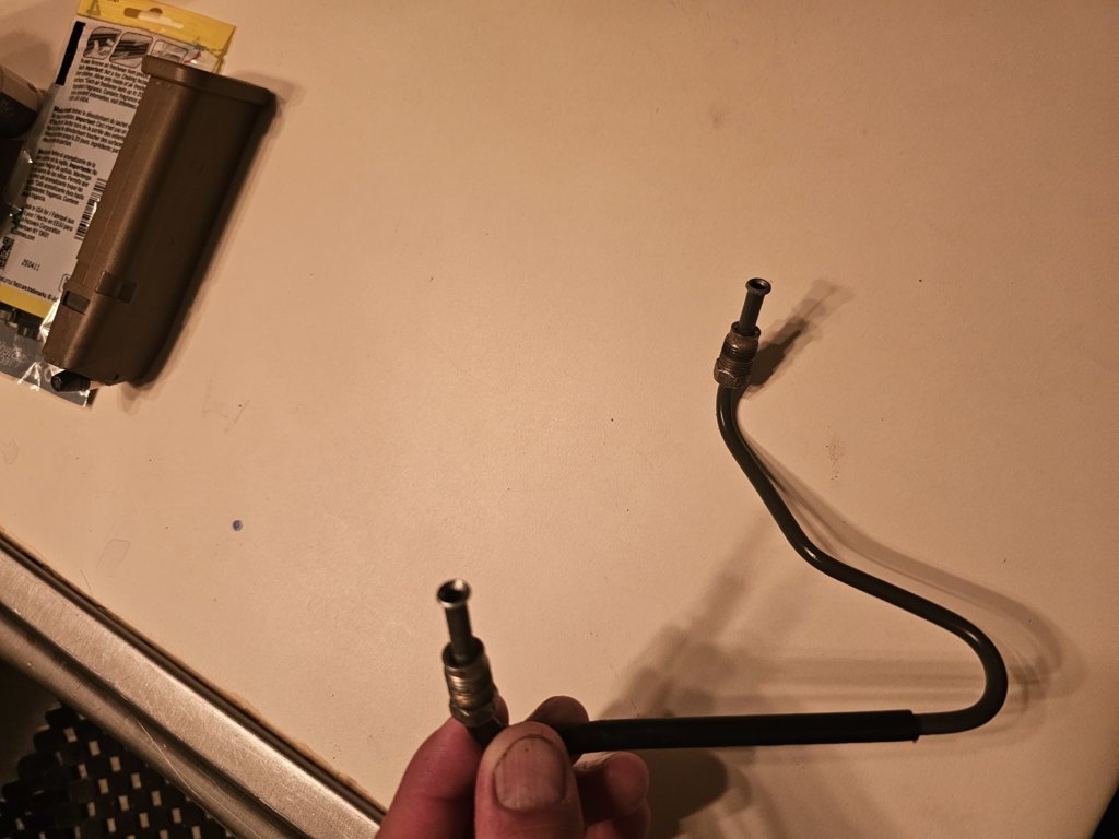

Help, where can I get a new front brake line for my 2004 tacoma ?

    Messed up the fitting trying to undo it to upgrade to tundra brakes

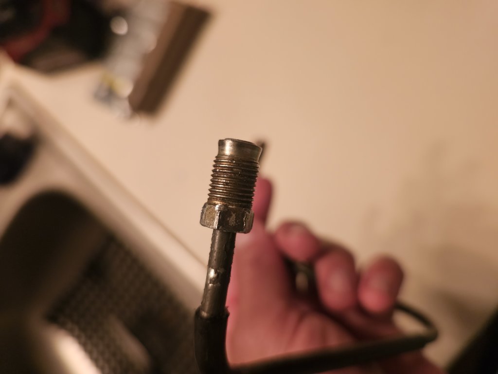

    Which fitting - can you attach a photo?

    Kinda pancaked the fitting by accident, so now it doesnt go back in

    Go to Napa and buy a ~12” straight m10x1.0 and bend it to place. Possible be around 10 buck

    Sorry, should have been more precise with my question.
    * Driver or Passenger?
    * ABS or no ABS? (seems to only matter for passenger)
    Regardless, here's the answer no matter what your answers are :)
    Diver: 47315-04060
    Passenger: 47314-04060 w/ABS: 47314-04050
    This is certainly an option, but a lot of folks don't have the tools to do the correct flares, etc. New Toyota part is only ~$10, but there's the downside of waiting...
