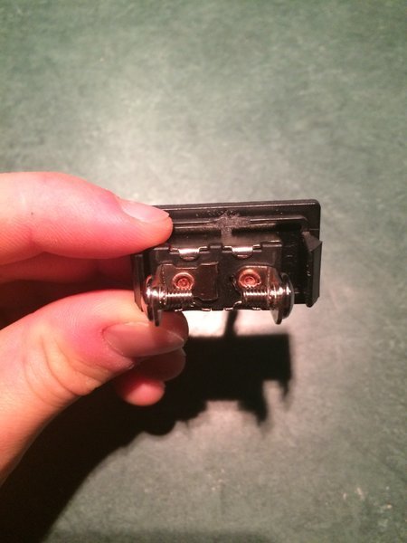

    Which side is the ground? I figured I'd set the ground, but the terminals are different. Does it matter? Thanks.

    Neither, hot goes in - hot goes out. If that is a switch, what is it?

    I was going to use it for the switch for my auxiliary lights that I'm wiring up. So you're saying the switch can't be used?

    Why can't I just ground one side?

    you can use it to turn power on n off to lights.
    if you put power to one side and ground to other side of switch i t will blow fuse and who knows what else

    You can if you are feeding B+ directly to the lights and switch the ground.Otherwise you will be doing some melt down

    A switch like that doesn't get grounded. You just use it to complete the hot wire run (on) or break the hot wire run (off).

    because there is no ground on that switch.
    Hot in, hot out.
    The only switches that are grounded are the switches that have a light for illumination.
    In this case Ground your accessorie, not your switch

    Now show him a schematic with an un-illuminated switch, like the one he has in hand. Two terminals, no ground.

    I was actually using this picture a short a reference. See, the switch is grounded? Don't make me feel stupid.

    After seeing that picture do y'all understand my confusion with grounding it? Since there's no indication to the switch being illuminated.

    That picture has 3 prongs. Hence one for grounding it. Yours has 2 prongs. Both are positive. No confusion there.

    The switch in the schematic has 3 connection points. Yours only has 2.
    I guess the good news is you asked, rather than assuming and burning stuff up.
