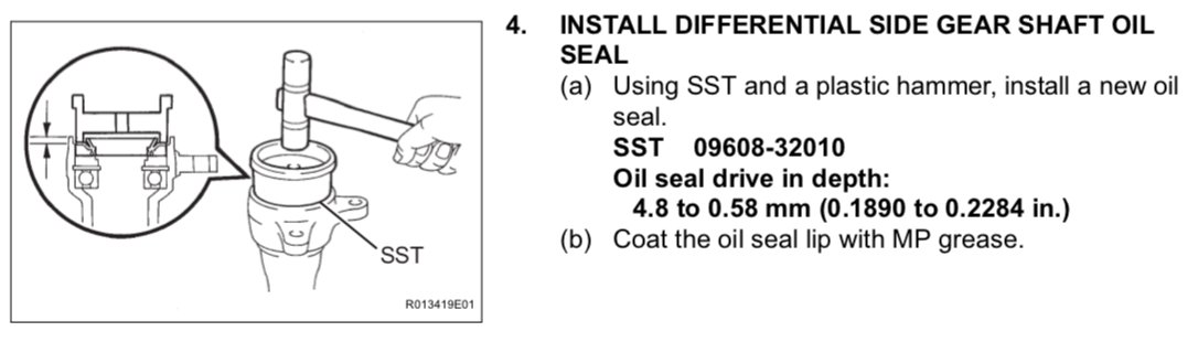

    This is what the factory manuals shows. Not sure if it's the same for both sides. It's been a while.

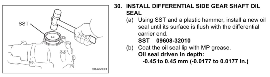

    I believe this was the confusing part. The passenger tube side is deeper. Like I say, it's been awhile and now that I look at this those two ears look odd to me. I don't know now.
