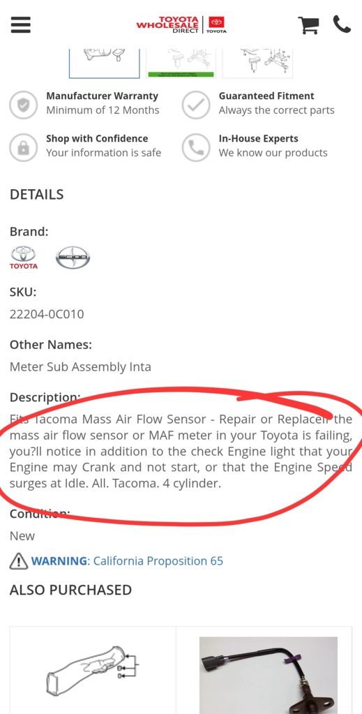

    Lol! I worked all week! Today was my Saturday. Anyhow, had it towed to my trustworthy repair shop. Codes were P010012, P160400, and P160500. Said they cleaned the Mass Air Flow Sensor and it got better but was still surging on start up so they are replacing it. They said the fuel readings were crazy high. They are pretty sure thats the problem...said it may have stemmed from K and N air filter I had in there. But I've had it in there for like 4 years with no issues, and I haven't oiled it in quite a while. But I'll toss it and put a normal one in there anyway. Thanks for all the suggestions and help...appreciate you guys.

    Sounds like this was the culprit

    Well, at least we finally also know what engine you have too. Let us know if the MAF was in fact the issue when all is done.
