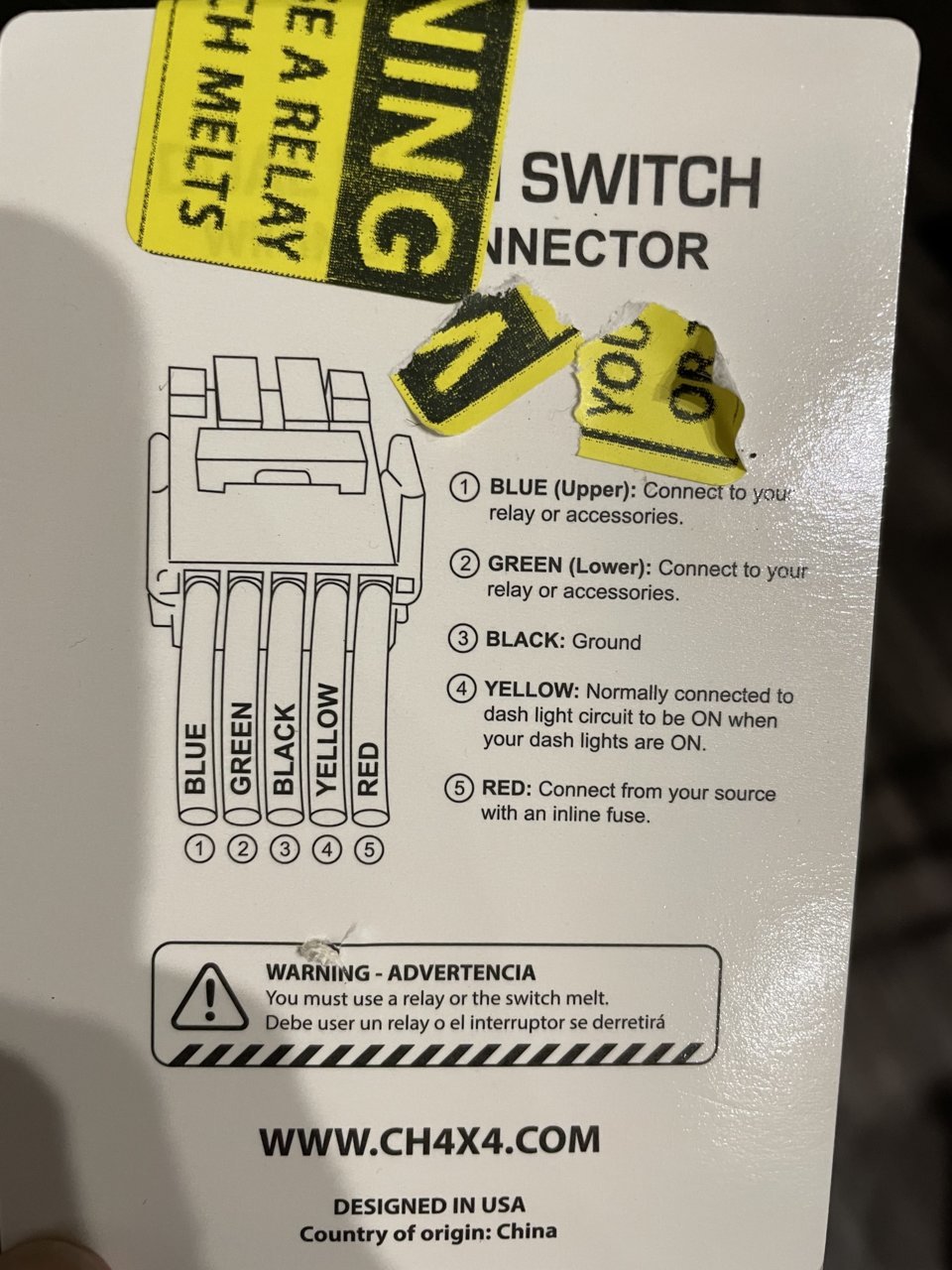

    As an FYI to anyone with the dual switch from ch4x4, the compressor harness can be ohmed out to determine that you don’t need to run as many wires. Here’s what I did to wire up the compressor and front locker dual switch (though I haven’t tested the front locker given I don’t have one yet, but this will save me from needing to change anything or go through the firewall again).
    iso = isolation switch
    Sw1 = switch 1
    Sw2 = switch 2
    NC = no connect
    ARB > ch44
    Sw1 red > NC
    iso red > blue
    Sw1 black x1, iso black x1 > black
    Sw1 black x1, iso black x1 > NC
    Sw1 yellow > green
    Sw1 bluwht > NC
    Iso redyel > red
    Iso bluwht > yellow
    Edit: I’ve concluded that you need to run a relay for these. Amperage pulled at DC os 0.367 A but there must be enough of a surge. There are others who wired singles just fine so my guess the duals are rated for less amperage than CH4x4 lists.

    I just hooked the switch directly up to the relay. You won’t need a fuse in-line. The relay will pull under an amp and will only pull that much for a little bit until capacitance is charged up. Then it should be pretty minimal to hold it open. My fuses all supplied power to the relay
    if you tap a switch into a fuse it would be for the light. Which you could use 1 A or even lower it’s just an LED. I think the smallest they have is 2.5 A and those are hard to find. 5 A would be fine too. Worst that happens is the LED fails short but it still wouldn’t trip either of those fuses

    Typically your power wire is supplied via an add-a-circuit. This puts the fuse inline from the battery and keeps it separate from existing fuses. There should be specs on current or power it pulls but if not can measure it or ask crutchfield
    if you go straight to your battery instead then yes you need a fuse on that wire. That’s how the compressor from ARB works. You could also do a fuse block but I haven’t needed to do that yet since I don’t have that much stuff hooked to my battery directly yet
