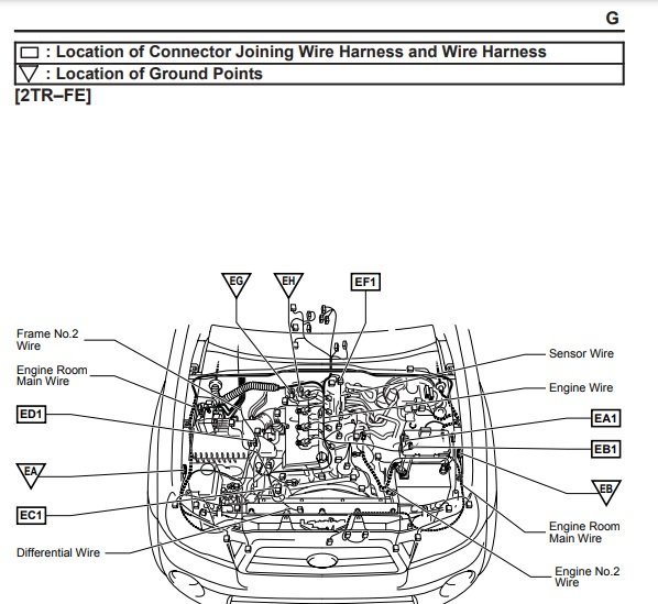

    What’s up guys,
    I got an 2006 Tacoma 4WD regular cab (manual transmission). I can’t seem to find where these two wire pieces go. Looks like two ground wires by the firewall. Any help on where these two wires hook up too? Or exact location???

    If they are White/Black I would assume they are grounds as that is Toyota's wire color for ground's, to be in that position they would have to belong at ground point EG or EH which I believe is the rear of the cylinder head.
