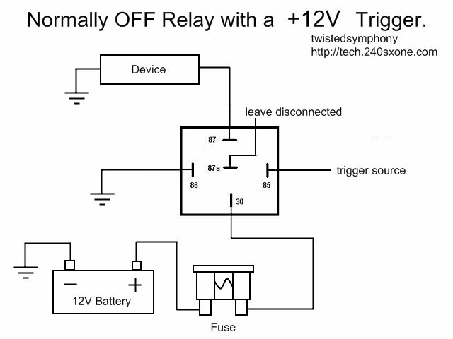

    First post here. I've been looking all over for examples of what I want to do but having some trouble figuring it out. I have a 2014 tacoma and would like to install an on board water system for rinsing after the beach, scuba diving, and general washdown use. This is similar to how I'd like it set up: https://www.tacomaworld.com/threads...ystem-for-the-2005-2017-toyota-tacoma.453005/
    However, instead of a switch at the back, I'd like to wire it to a push switch on the dash like this:
    What would be the easiest and safest way to do this? Should it be wired directly into the fuse box behind the little change box under the switches? Should it be connected directly to the battery or can it be safely tied into the truck another way? Would I need a relay? The pump draws little power (product specs say 1.7 amps, max 2.7). I know next to nothing about electrical work and this would be my first project like this. I don't want to mess anything up, but I'm excited to try it! I'd love any feedback or resources you guys can offer a noobie such as myself. Thanks!

    I always like to run relays. Back in my early (broke) days in high school, I never used relays. That changed one time, when one of the switches had too much power being pulled through it, and fused itself in the closed position. I wasn't able to turn off the device until I ripped the switch out of the dash, and yanked the wires off. Since then, I always use relays with switched devices.

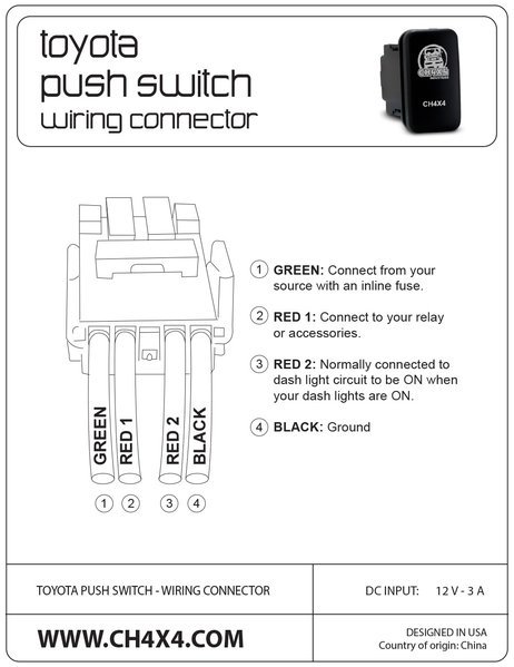

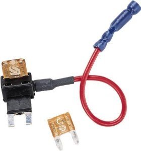

    Use an add-a-fuse from fuse panel to the switch (green).
    Run the wire (red 1) from the switch through the firewall grommet behind the kick panel to the engine bay.
    Use inline fuse from battery to the relay. Then wire it to the location of your choice for the pump. Use a waterproof relay.

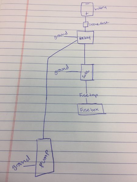

    Thank you so much for your feedback! I made a quick rough diagram of what I'm thinking for the wiring, but I'd like to see what you guys think. I definitely want to do this right the first time.
    Apologies for the crappy drawing and lined paper.
    I have a few other questions as well (and plenty to follow I'm sure!):
    How do I determine what amp in-line fuse I need? And the fuse for the fuse tap for that matter... Obviously a fuse can be rated too low to handle the load, but can it be rated too high to be effective?
    Also, is connecting directly to the positive terminal of the battery the best solution? I want to avoid modifying any factory wiring, but are there any other power points that can be used?

    @Teleost, verify the draw of the pump FIRST. The wiring setup will depend in the peak draw.
    Most of the ch4x4 and the mictuning push switches are 3 amp max. If the draw is 1.7 amps, you should be fine with running just a switch. However, if you misread or the person entering the specs put a . where there shouldn't be one and it is actually 17, you need a relay.
    The way you drew it is correct for using a relay. Just missing the wire from the switch to your factory dash light circuit.
    As for getting power, I just put an eyelet terminal on the end on my wire, took the nut off the terminal clamp, put the eyelet on the bolt, then tightened it back down. I don't know about your truck, but mine also has a stud on the battery terminal. I would have used that, but mine was really tight and I didn't feel like fighting it at the time.
    Fuses needed will depend on how it gets wired. My add-a-fuse circuits that use ch4x4 switches to control relays use 3 amp fuses (purple I think) for the power wire going to the switch. Fuses for components depend on the draw.
