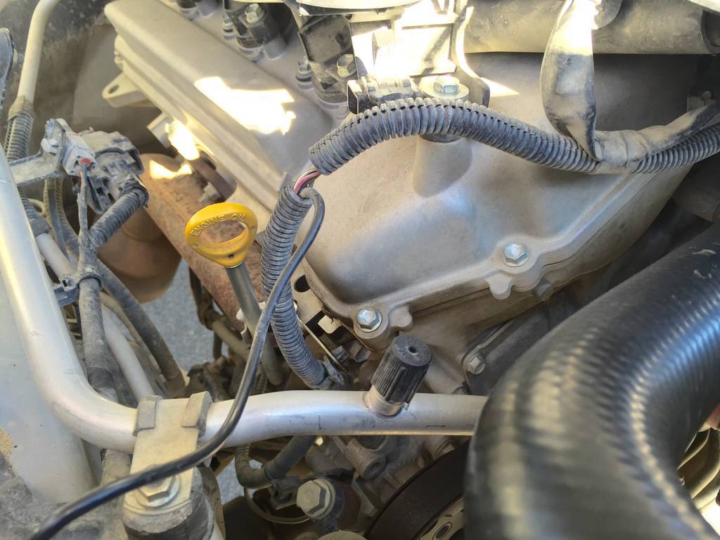

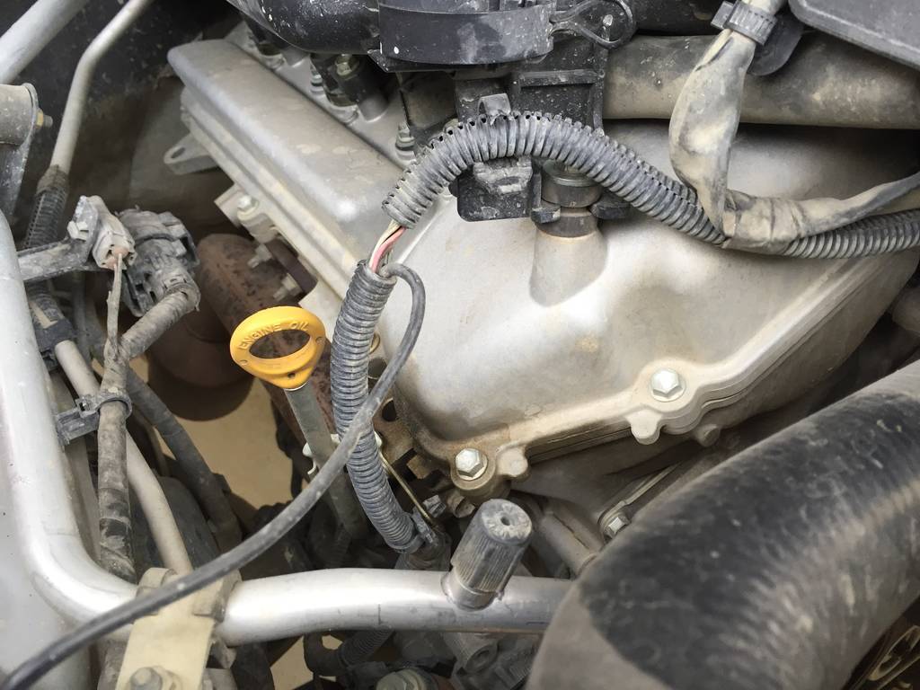

    I just noticed mine a while ago. Thought it was from the oil dip stick at first. Here are some pics before I wiped it down. I'll get some more pics tomorrow. Now has 500 miles after I wiped it clean.
    150,500 miles

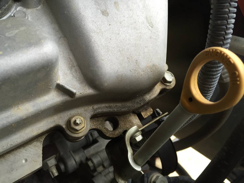

    here are the pics,

    Heres from the drivers side

    Does it look like a valve cover gasket issue or timing cover gasket issue? Well either way im going to clean it all off and see if I can distinguish where it originated from. Thank you all for the pics/help and any additional advice or solution is appreciated

    Both. It looks like you have small valve cover leak and timing cover leak as well.

    I had that and I re-torqued the bolts and the leak hasn't come back. Try cleaning it and tightening the bolts down.

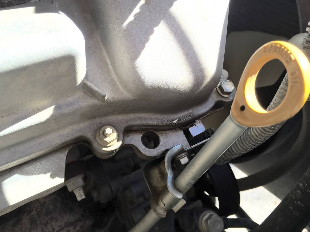

    This is about 500 miles after I cleaned it. Just took the pics.
