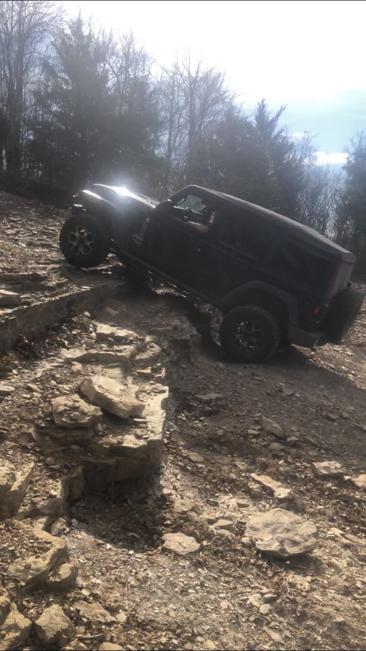

    Honestly I’m not looking to do any difficult off-roading but I was out yesterday with my current setup and I couldn’t go up a hill climb my buddy with his jK was able to do with a 3” lift . I didn’t have the clearance for it .

    Here he is on the Jeep

    Crawling over rocks like that you need larger tires to help raise your axles. Larger tires means you need wheel well work to make the larger tires fit, then you will need a better suspension lift to make the tires fit, then you will need upper control arms, a CMC, skids underneath, wheel well punch work, and so on. Do a search on TW...in the upper right corner search making larger tires fit and read what the folks are doing to make larger tires work! You said budget friendly...there is NO budget friendly about it if you start down this rabbit hole.

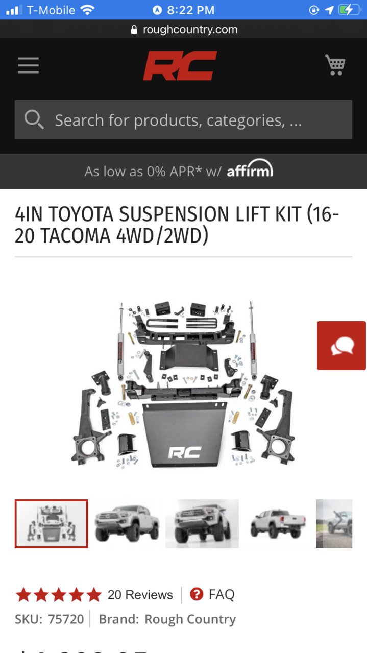

    Anyone running the rough country 4” lift? Just trying to get as much info as possible .

    you gain less clearance with bracket lifts unless you put on 35’s+...Do you understand how this works?
    and WTF? I literally just mentioned this brand as garbage...seriously trying to help you with that one. For literally $200 more you could do much better for your rig.

    I new to the Offroad game so don’t know much about lifts . But I been doing a lot of research now trying to find something that will work for me . I did rule out the RC kit .

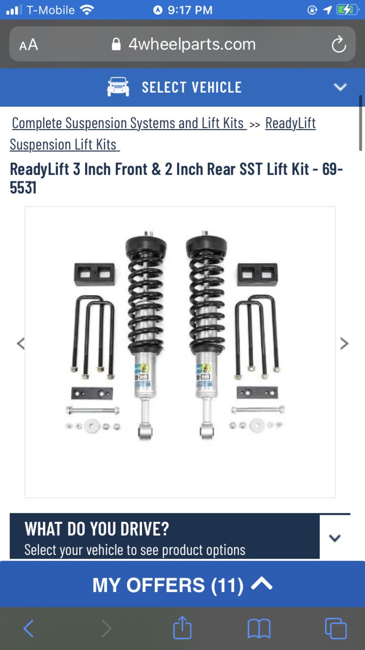

    Any Input on this kit .

    Comes with differential drop spacers, sway bar spacers and carrier bearing drop spacer.

    Nice kit. You will luckily need UCA’s also. Look into an aal set as well.
