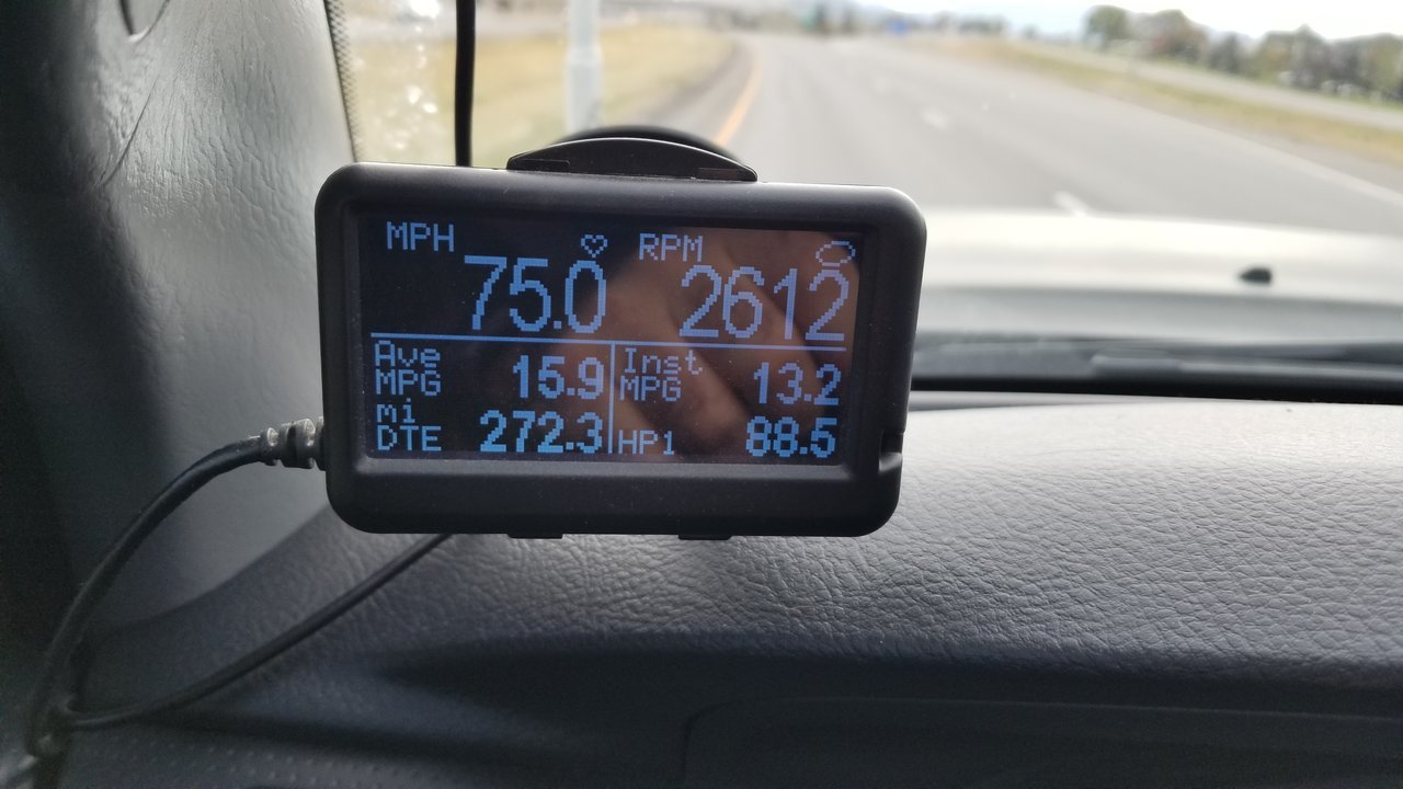

    I'm running 4.56 on 33s. But I've got armor and shit. Therefore heavy.
    Just for reference: V6 Auto
    Long term the goal was 35s.
    Edit: OP is Manual so my info is useless. LoL

    Also, is that MPH a gps or via the truck, if its via the truck its reading low due to bigger tires. (speed is read at the wheel speed sensors and not at the trans, so gearing does not effect measured speed)

    It’s an UltraGauge and it has been speed calibrated. Confirmed by GPS and Police radar trailers.
    There’s a reason I did not photograph the tach/Speedo.
  11. Nov 8, 2017 at 10:48 AM
    #31
    nd4spdbh
    nd4spdbh Well-Known Member
    Oct 7, 2013
    #114055
    14,582
    SoCal
    13 DCSB TRD OR v6 Auto
    Boom. perfect. Thats actually a good reference for the OP. 4.56's on 33s at a true 75mph in an auto.... OP's truck will be spinning a bit faster with only the 0.85 OD gear vs the 0.72 of the auto. In fact it would be right around 3050-3100 rpms at 75 true mph with 4.56's and the 6mt.

    I have full skids/sliders, bumper w/swingout, bedslide, 33s and 4:56s. They are good for trails, not highway. IMO city driving will be better, highway will suffer.
    I never go over 75, but my RPMS are around 3k at 75, if I remember.
