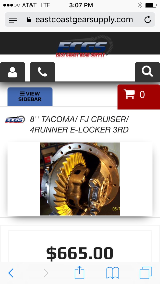

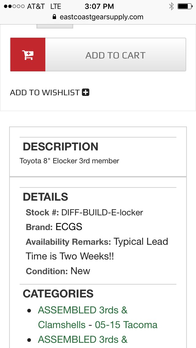

    When you click on the rear third member, there is no option to add a lock, like the front. That and the description of the rear, is what I was referring too. IMG_5266.jpgIMG_5265.jpg

    The 8” is Off-road models only.... which are already locked. Thus no locker option.
    Sport, SR, SR5 have 8.4” rears and no locker. Thus, a locker option.
