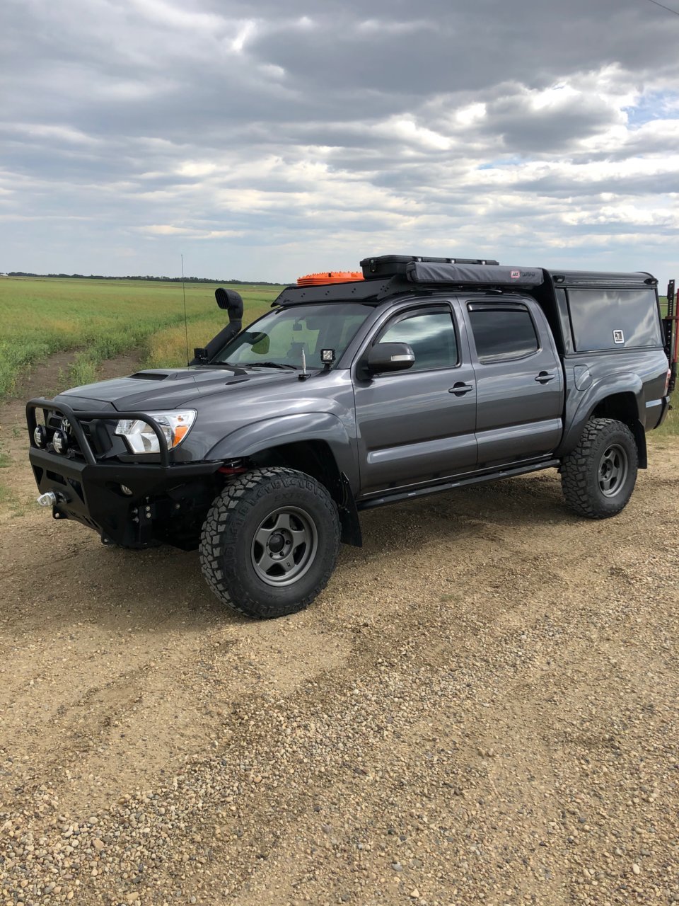

    I re-geared last year to 4.56 with Harrop e-lockers. I'm a 6-speed on 255/85R16's with a heavy and not aerodynamic truck. I'm glad I went with the ratio I did as the truck is MUCH more drivable and it works great off-road. I am slightly over geared but I take my time on the highway and stick to about 70mph. If I was not as heavy, I'd have likely went the same because the difference between 4.30 and 4.56 is only ~300rpm at highway speed but the truck is so much nicer to drive. If I was in an auto with the same specs, I'd have went with 4.88s. If you're not heavy then it may be better to just stick with the stock 3.73 since the change to 4.10 or 4.30 would not make a huge difference. Of course this depends on what your truck is used for, how you drive it, etc, etc. YMMV.
