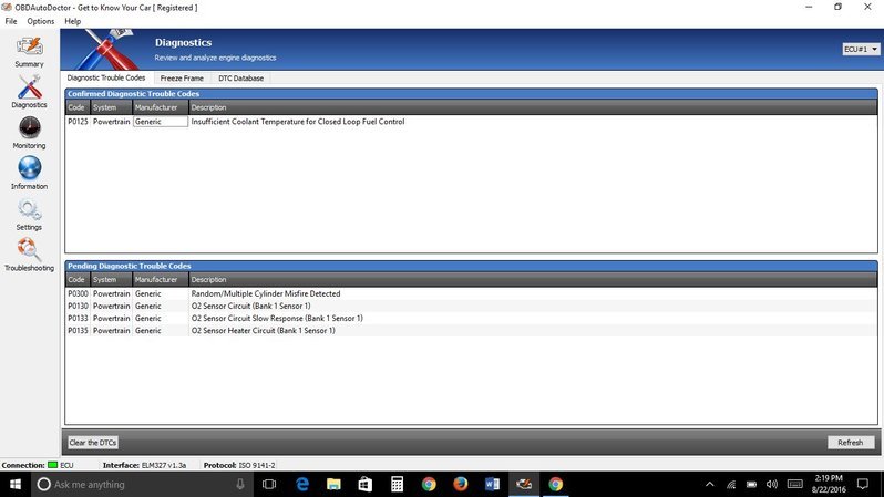

    I am helping my neighbor with his 98 tacoma 4wd with a 2.7l 4cl.
    His CEL came on and has stayed on.
    It has a heavy shake during idle. It seems to run and drive ok.
    I coded it and it comes out with p0125 confirmed dtc with a few others pending.
    I opened it up and took a look at the plugs... he doesn't know much about cars and the guy he took it to was a shade tree mechanic who put autolite plugs in and barely screwed them in ;/.
    I put ngks and gapped them properly and cleared dtc to check if it was the plugs. The dtcs went away for a short time maybe 40 miles then came back on, so i coded it again.
    Same confirmed with same pendings, so plugs didn't fix it :(.
    I don't want to keep replacing part after part on his truck, so i was wondering whats your guys opinion? I was thinking on maybe the o2 sensor bank 1 sensor 1 since that's what the Diagnostics heavily pointed towards.
    Will post a picture below of the coded screen. Any opinions and advice greatly welcomed.
    Thanks Guys.
    JP

    The repair manual will help explain what the root cause of any DTC is. The chart with all DTCs is in Diagnostics/Engine/dtcc.pdf.
    P0125 is for "Insufficient Coolant Temp. for Closed Loop Fuel Control". Could the thermostat be bad, so the engine isn't reaching full temperature? The other O2 codes could be a symptom of this.
    ...but I'll add that there may be something lost in the translation regarding "Coolant" because the repair manual seems to only talk about the heater circuit for the O2 sensor for code P0125. So, if the coolant is the correct temperature, then maybe the heater circuit for the O2 sensor is bad or the heater is burned out.

    The pending codes relate to the up-stream O2 sensor. I've read somewhere (on the Internet, for what thats worth, :D ), that a bad 02 sensor can also trigger a p0125, not sure why. Therefore, if this were my truck, I'd replace the up-stream 02 sensor. Easy to do, but the sensor is pricey.

    Would it code the engine though if it was a bad o2 sensor?
    The CEL went away for the ECT sensor code after I replaced it. There are not any other pending codes and the CEL is not on. This is one of the reasons this is driving me nuts. I am horrid at diagnosing vehicles.
