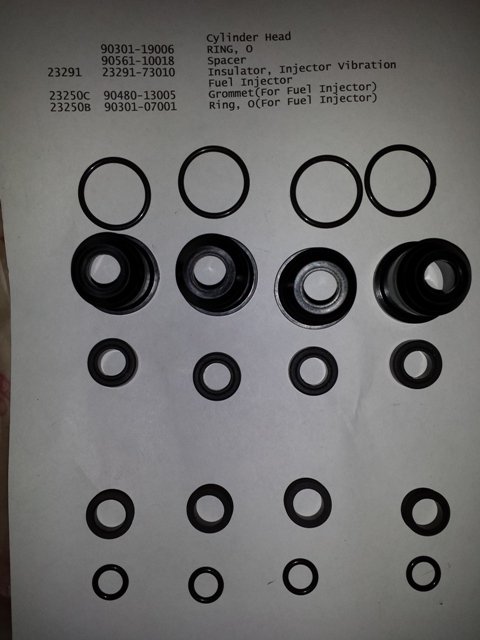

    From a 96, 2.4L. The parts are listed in order at the top of this picture. Should be the same or similar to a 98, but not 100% sure. There is an insulator in addition to the grommet and 2 o-rings. And a light coat of gasoline to lubricate during installation.

    I would not think it would be a problem if it fell in, just want to make sure you have all the parts. These o-rings shouldn't be reused. I'd bet the big o-rings that go behind the spacers will just crumble apart with the spacers.

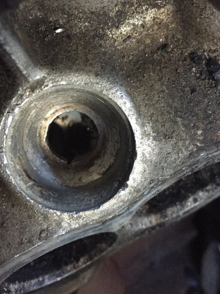

    I finally got all of the old spacers out. It was a major battle, but got them out without anymore plastic falling into the head. However when i finished getting the first one out I saw that it had a crack or a slice hard to tell in the middle of it.
    It Doesn't look huge but would it cause any issues. I would think the new cup would just slide right over it but wanted to see what you guys think. Also going to order new o-rings tomorrow just want to be safe and not re use old ones and cause the issue not to be fixed.
    The pics are both of the same injector hole. I just tried to get a close up.
    Thanks all.

    I'd try to clean the holes up a bit. Maybe you already did. It's hard to tell from the pictures. A minor imperfection shouldn't matter because the rubber o-ring between the metal and spacer should prevent any air leak, but you could judge better than me once you get the parts and see where the o-ring will sit in the opening.
