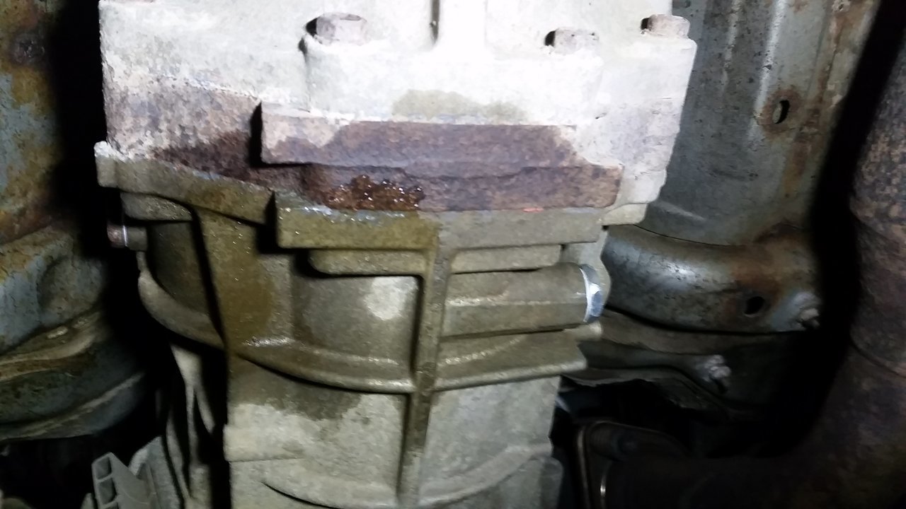

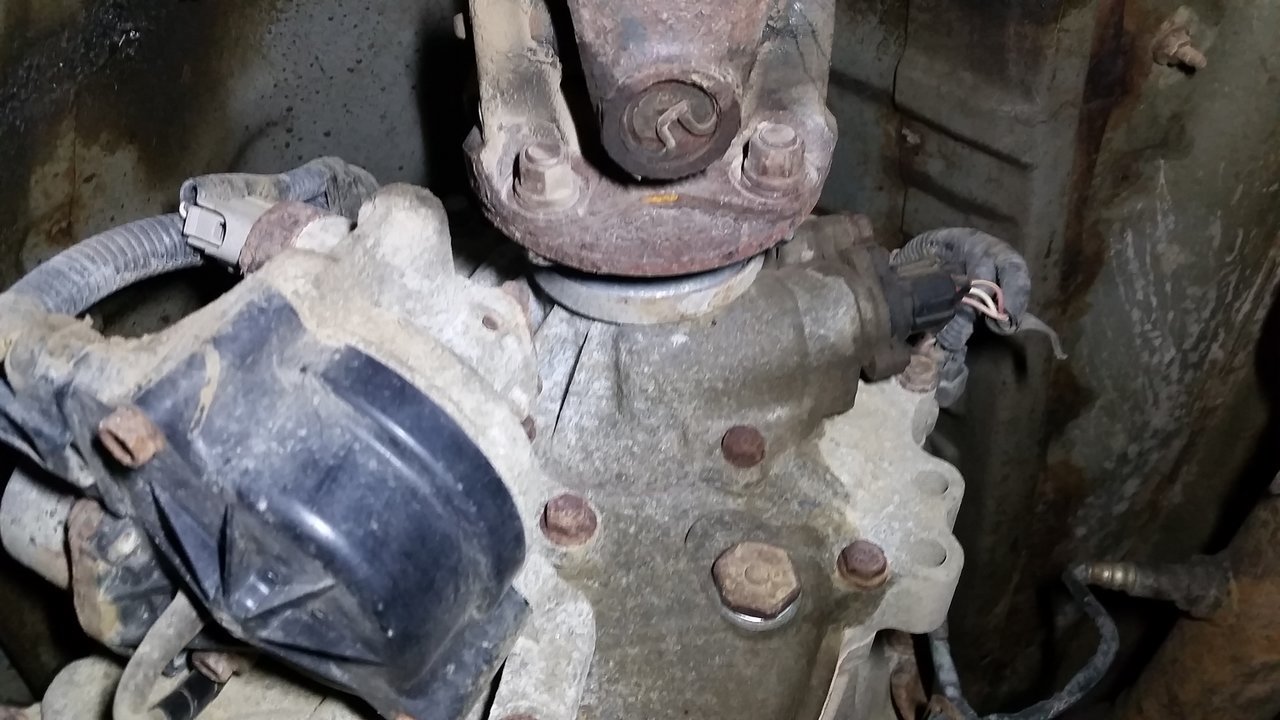

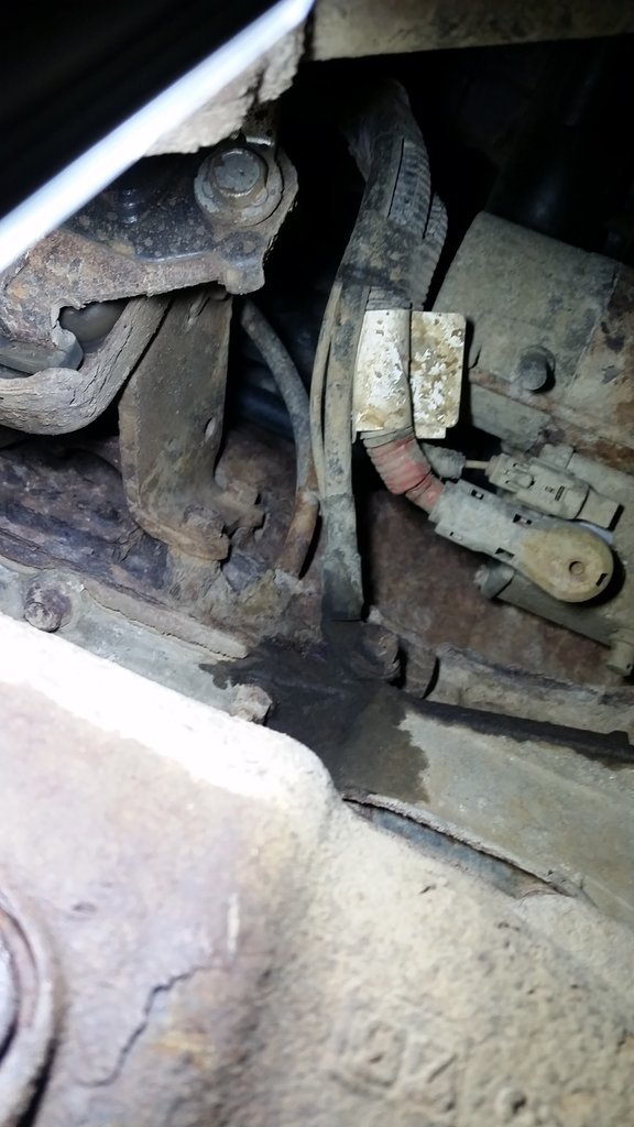

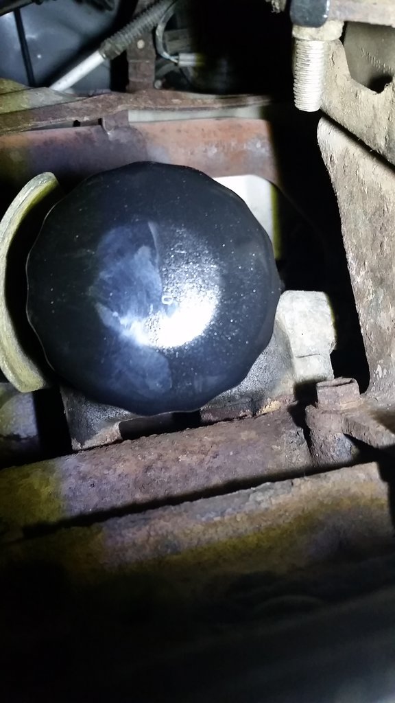

    I spent some more time looking around the transmission and did find another seep on the seam? of the bell housing, so I took a few picture if that helps.
    The first one is right by the starter motor on the drivers side front, second pic is the one is coming from ABOVE the filter, and I know I didn't spill that much when I last changed it. And the last two are obviously the tcase and the underbelly of the bell housing, both leaks are new since last night (100 miles tops), and look like fresh oil.
    Starting to feel like switching the engine and drive train oils to synthetic was a really bad idea, at least on this truck. Gonna get it in the shop asap and have them take a look :(
    From what I've read if it's a main seal it could be seriously hurting the engine, can anyone tell me how dangerous/dumb it is to keep driving her with all these leaky spots and slippage?? I haven't noticed any weird noises or high temps, but the clutch slip does seem to be moving into lower gears a little bit (third over revs a tiny bit now if I push it)
    Sorry for the essay, but I'm pretty worried about this since things are springin up all over the place.

    That last pic looks ominous for the clutch- Looks like you will have to replace those seals when you take offf the tranny,
