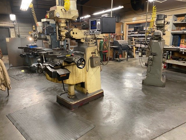

    Is that a proto trak? 2 or 3 axis?T mill will do tricks sporting one of those. I used to work with a machinist who also worked with wood to pretty much the same tolerances. He made custom rosettes for interior door trim.

    It is a proto trak. 3 axis.
