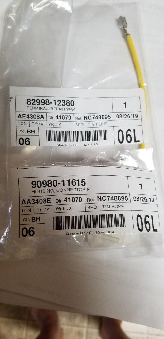

    Well, I am 97% sure I have this connector and pigtail situation figured out. Here's 451 pages of everything you ever wanted to know about Toyota connectors.
    https://www.toyota-tech.eu/wire_harness_rm/RM06H0E.pdf
    Based on other posts here on TW, I'm pretty confidant that the connector body for the fan switch is 90980-11615.
    Based on the chart on page 380 of the above link, I'm fairly confidant that the pigtail for that connector is 82998-12380.
    Use these numbers at your own risk.

    Life with a wife and three kids is making this a slow process for me. I finally got all the parts I need, for those that may find this thread in the future i posted a pic with part numbers that i got.
    My electronics skills are lacking and I dont trust myself to cut splice and heat shrink so I've already found a shop that will do the work for me for 65 dollars. Opening that plug and cutting factory wiring makes me nervous
