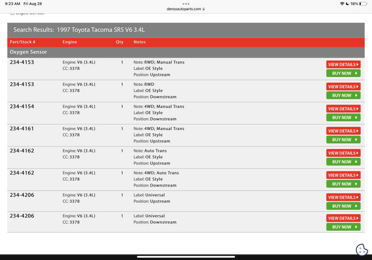

    Based on what I looked up, there are a few different options for sensors...
    234-4153
    Note: Exc. Calif.; RWD; Pre-Runner
    Label: OE Style
    Position: Downstream
    234-4162
    Label: OE Style
    Position: Upstream
    234-4206
    Label: Universal
    234-4206
    Label: Universal
    Position: Upstream
    Any difference between "OE Style" and "Universal"?

    Use only OE style
    Universal can be any number of undesirable differences including screw in type without flange, wire length, connector, rubber body plug, bla bla bla.

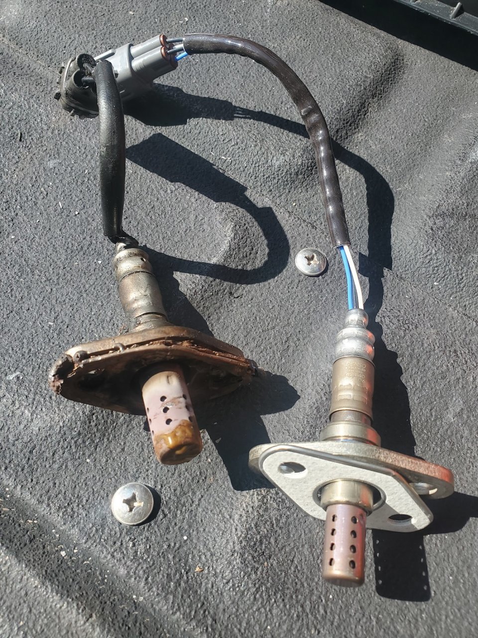

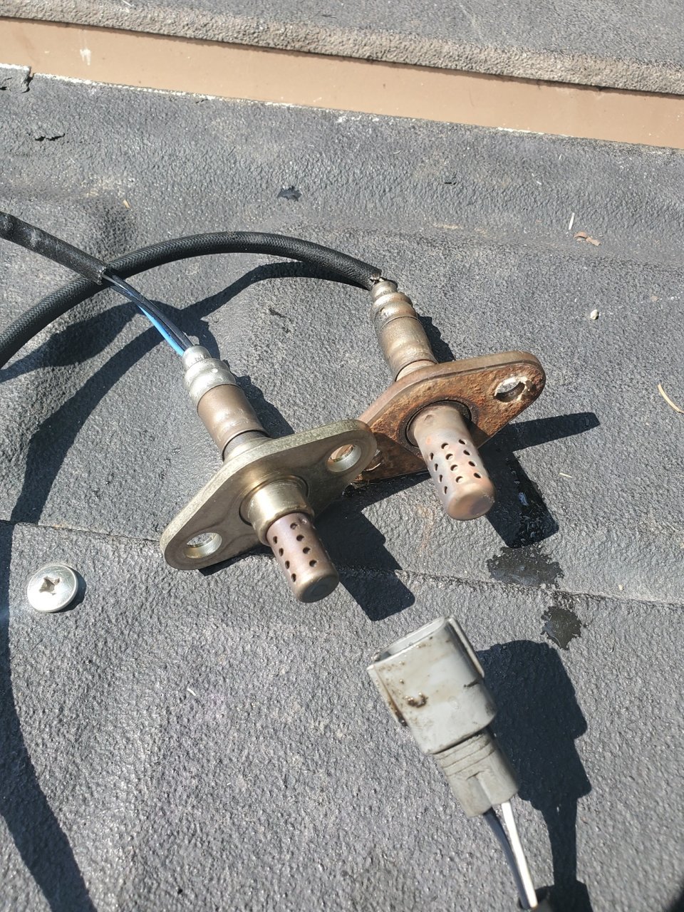

    Got both sensors replaced on the truck this morning.
    The nuts holding these in place were pretty seized and damn near melted onto the exhaust.
    Penetrating oil, a torch, and some vice grips finally got them off.
    Upstream sensor (Denso 234-4162) had a slightly different barrel size and four intake holes instead of three, not sure if it makes a difference.
    The downstream sensor (Denso 234-4153) was about the same as the one it replaced.
    By the way, the exhaust nuts holding the sensors in placed were completely destroyed in the removal.
    The part number for replacement is 90179-08059.
