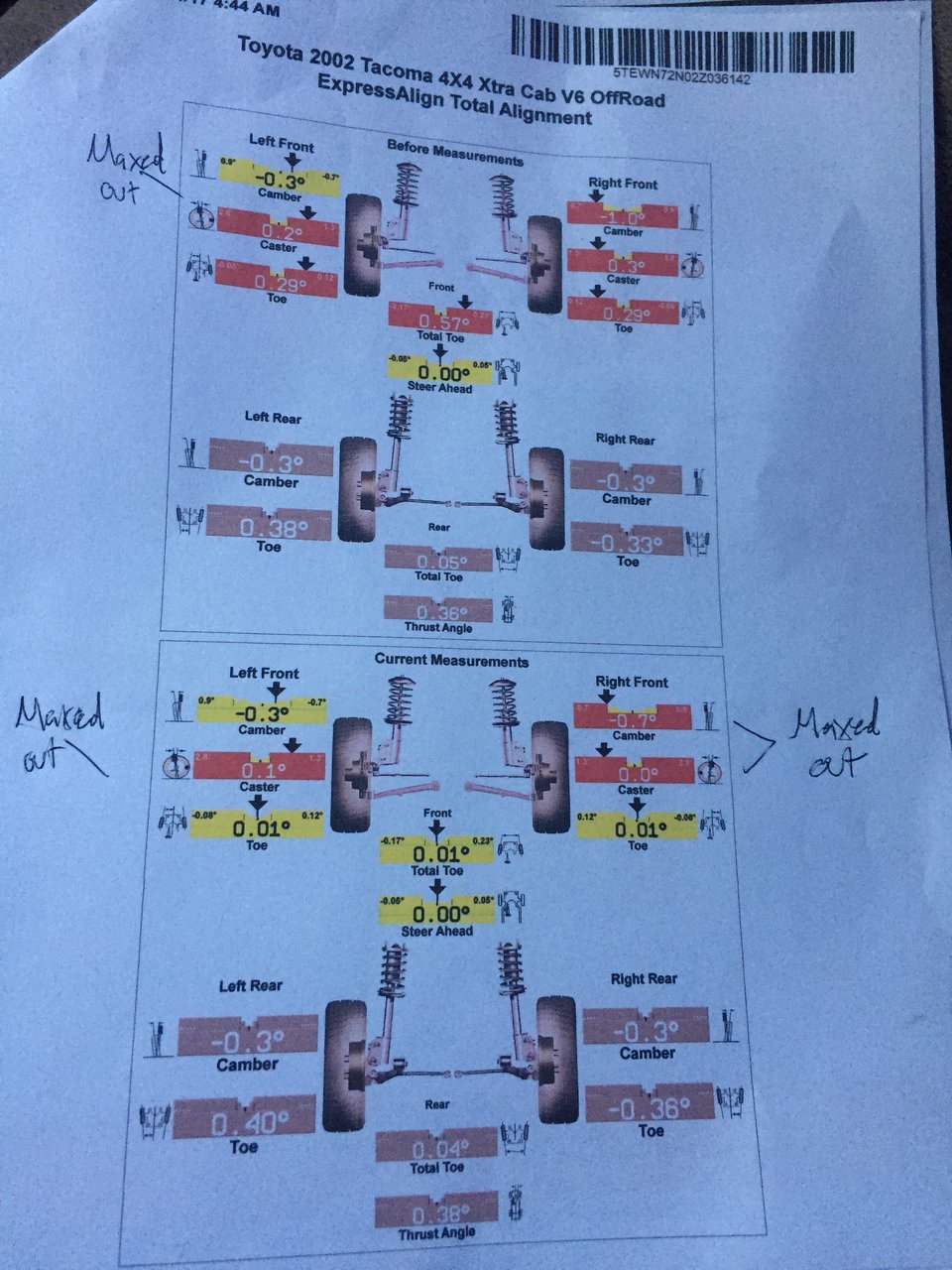

    Just went in to check on my alignment after hunting season
    They were busy kinda got crappy service
    Did not give me no explanation just sent me out the door
    I do alignment at this shop every 6 months or so to make sure everything is good
    And previous numbers looked a lot better
    What could have changed ?

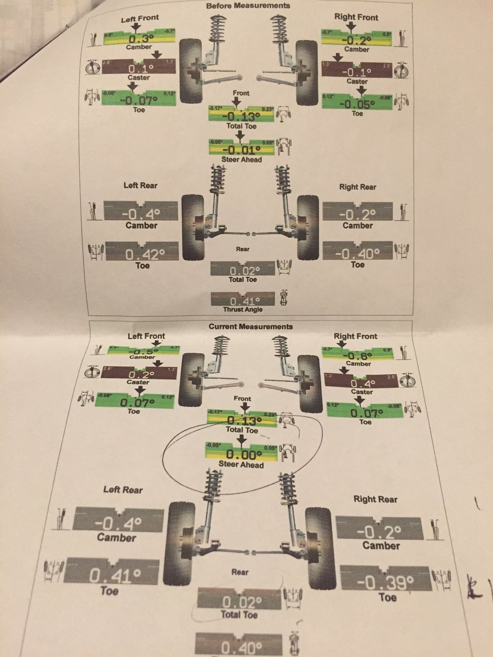

    Here is my previous "check up" from 6 months ago
    I guess they changed their colors
    Used to seeing green

    To much negative camber, and you should be able to get at least 1 degree of caster with a 3in lift id go somewhere else

    Should i be concerned about tire wear with these numbers?

    Doesn't look too bad from a tire wear perspective, front right camber kinda sucks but not the end of the world. Caster is terrible though, it's going to wander around on the highway and get squirrelly if you dynamite the brakes.
    If that's the best they can do, I'd look into adjustable UCA's so you have more control over alignment specs.

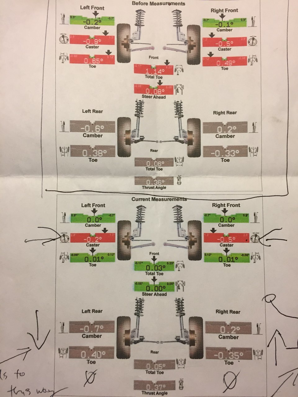

    Here is a pic of an alignment i did soon after installing new suspension

    Do you have the bilstiens set at the lowest setting with the 882? there should never be that low of a caster.

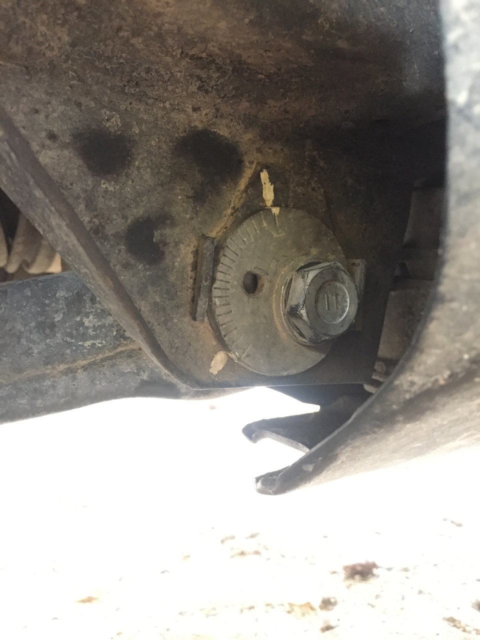

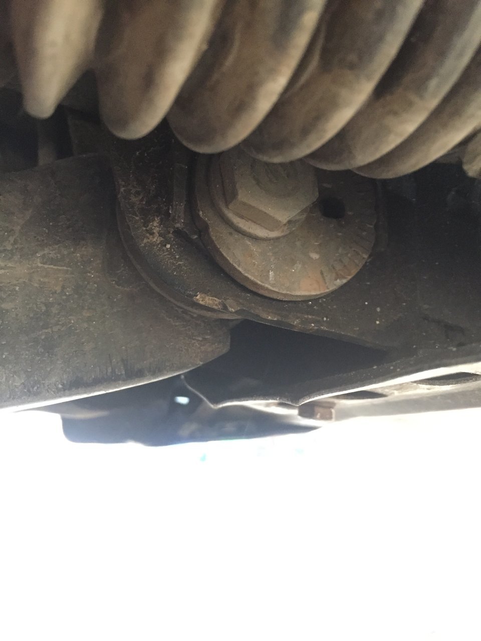

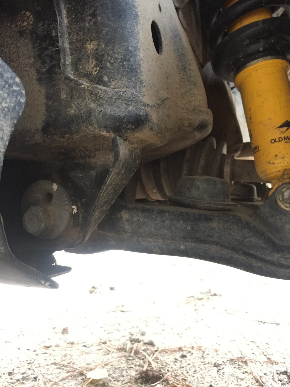

    Can you snap some pics of where the front and rear cams are
  13. Oct 25, 2017 at 9:02 AM
    ROlla-Xrs
    ROlla-Xrs [OP] Well-Known Member
    Mar 13, 2017
    #213201
    425
    Roman
    Elk,WA
    1st gen Trd Tacoma
    Drivers side Front/Rear

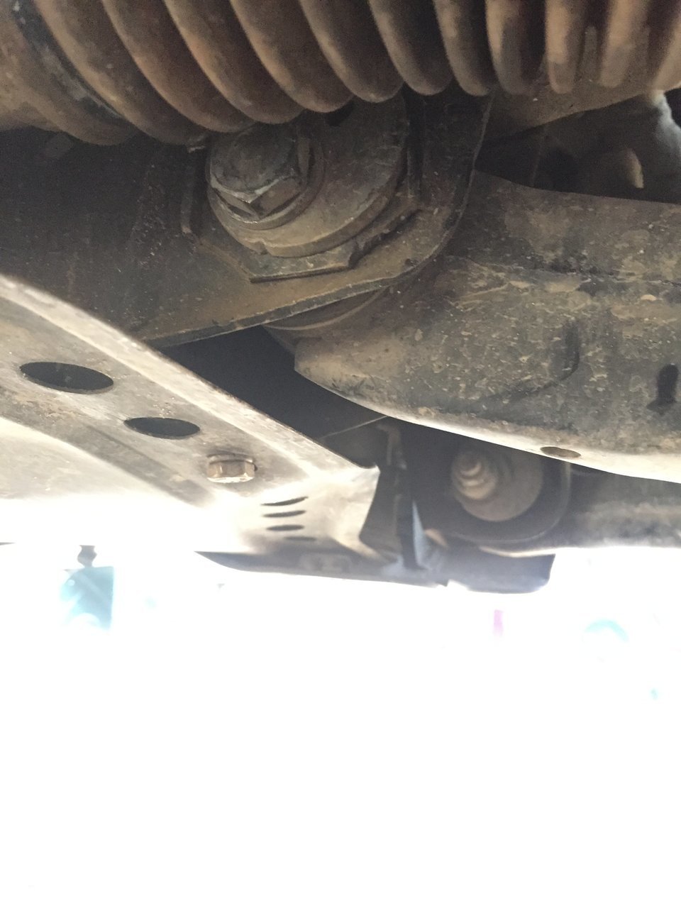

  14. Oct 25, 2017 at 9:04 AM

    Passenger side

    Drivers side looks ok, looks like they gave up some caster to get camber close. Passenger is whack, the rear cam should look like the drivers side rear cam, should be pulled all the way out or pretty close.
    Regardless, there's no way they're going to dial another 2 degrees of caster out of those and keep camber in spec. My vote is still on adjustable UCAs.
