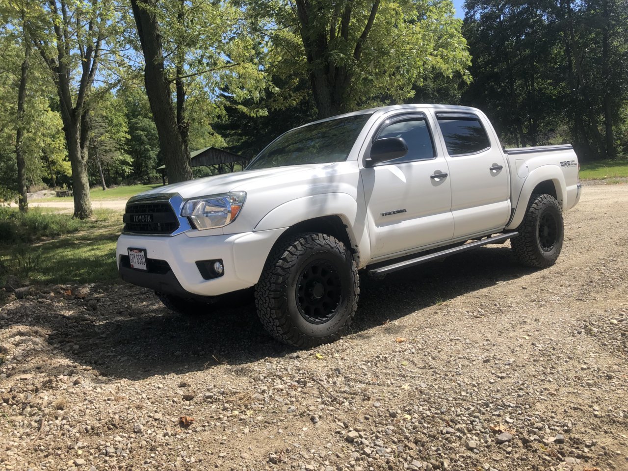

    I agree with whatstcp! You need to prepare for worst case scenario if you're setting your budget at $800.
    Everyone's truck has different outcomes with lifts. Some have 0 issues. My personal experiences have been 110% dog shit.
    I went down the "lift road" and had bad experiences with everything... creaks, vibration, etc., so I took all of it off. I still have a creak front passenger side, after I took everything off. Wasted a couple $100. Your truck can still look good without a lift (although it depends what you'll be using it for). I don't off-road (and sounds of it neither do you). My truck is my daily driver, only needing to drive through a field to fetch my deer! Get some 265 KO2's (trim just a little) and be happy you didn't get a new vibration issue after lifting, saving a little money.
    My truck, no lift, for a reference:
