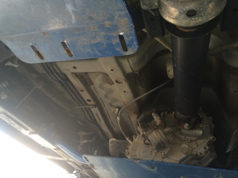

    So I got the bolts from budbuilt and I called for an email so I could see the installation instructions better... I was attempting to put the ifs skid on and nothing lines up with the holes on the skid plate to the skids on my truck... I even removed the front recovery hook thinking it would be in the way and it still didn't help... I bought them from a buddy that had them on a 2012... Before I bought them I emailed budbuilt to ask if theyd fit and they said the skids would... I tried to call and explain my problem but no one could seem to understand what I was saying... I don't have pictures right now... I'm going to attempt to put them on again on Wednesday or Thursday when im off and I'll post pics to get some better help... Until then anyone have any insite to what my problem maybe.

    you did remove the brackets for the stock skid, right?

    Yes they were removed I had an ato ifs skid on first

    No I took the ato off im installing full budbuilt

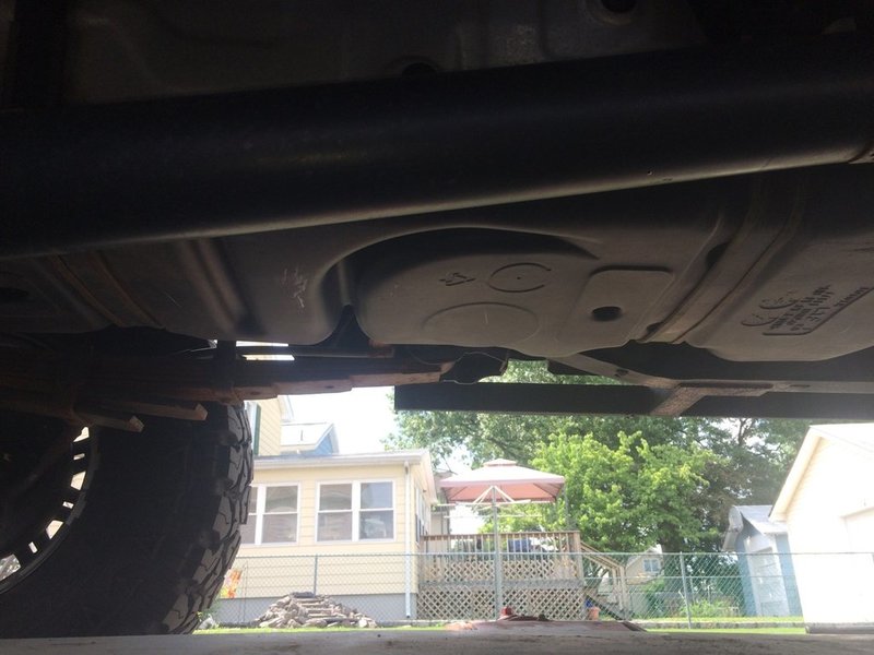

    ok so i figured out what the problem was sorry i haven't been on in a while i haven't gotten time off from work and i took a 4 day weekend to do this and now I've got one last problem:annoyed:so i went to install the gas skid and i noticed I'm missing a skid? and where the holes on the skid line up with the straps that hold the tank to the truck! :help::crapstorm::frusty: so now what? do i stabilize the tank undo the straps drill the straps and some how by gods graces bolt the skid to the straps and push the skid back to the tank some how keeping the tank in place and strapping it back to the truck? someone give me an easier way lol

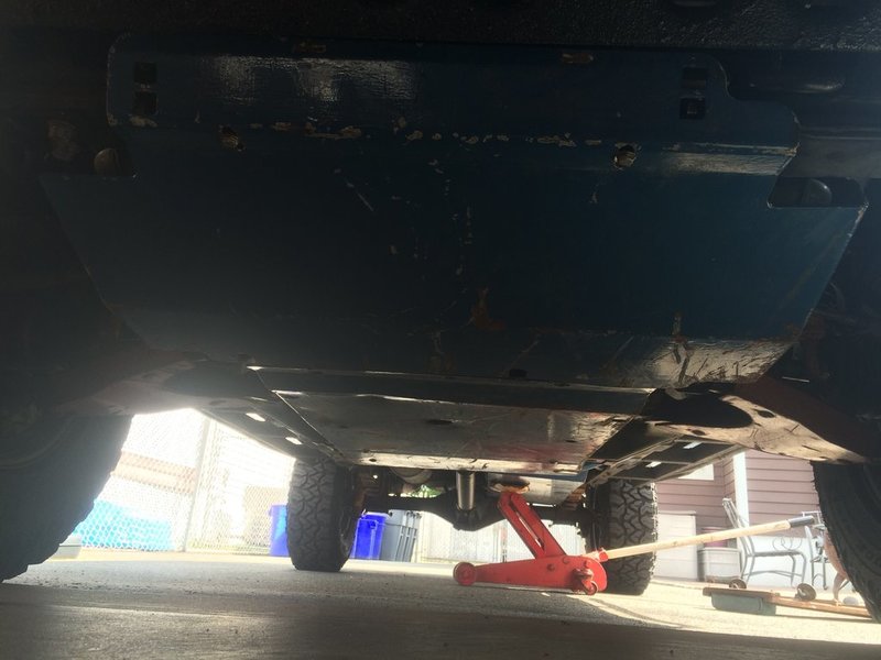

    Here's the rest put on

    My gas tank skid took some muscle and a jack to get it high enough to get the nuts on, tight to the tank... But now looks like rocks are getting wedged between the tank and skid... Anyone else have this happen?

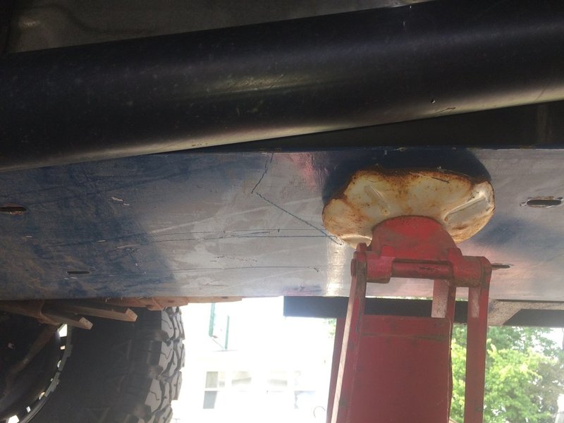

    Ah kk makes sense... what kind of nuts come with the skid when new? I just reused the old ones from the plastic skid... The nuts hang down quite a bit though so worried they will get snagged up and rip off

    I'm thinking of jacking the tank up and drilling holes thru the straps because I don't like how the bolts will be hanging out... I've got extra flat heat bolts to put on it to make me fell more at easy I've already got two nice gouges in the rear thank god it isn't leaking lol
