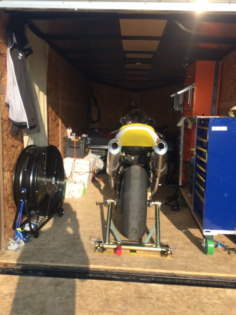

    I am currently shopping for a WDH myself so I don’t have an answer for you at present. I tow light with basically my race bike, tools and sleeping gear but did see a little sag. I don’t feel anything out of the ordinary but if it saves my rear springs over time then it is worth it.
    Here is my setup.
    Windows are going in as soon as it warms up. The roof is getting insulted for heat retention and to keep the aluminum from cooking me in summer. This is what I am using. 1” thick semi rigid fiberglass w/ aluminum backing. Not cheap but I want it to be insulation both for heat and noise because rain will drive you nuts on that aluminum roof.
