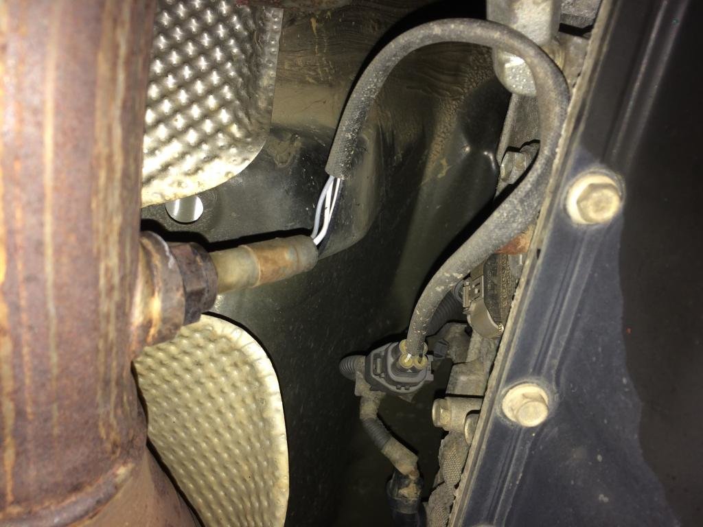

    If the CEL comes back on I'll do that. Wouldn't it throw an O2 code as well as the p0606? They're 4 sensors right? Are all 4 O2 sensors the same part number? This is one right?

    the sensor still reads fine but the element inside of it shorts out and back feeds the ecu. i think the rear sensors are the same part number and the fronts are different dont quote me. and yes thats one of the rear o2 sensors
    theres 2 air fuel ratio sensors in the manifolds and 2 o2 sensors after that.

    CEL came on again this morning. It's been 160 miles since cleared. This time p0606 was accompanied with p0138 O2 sensor high voltage bank 1, sensor 2. Which sensor is that?

    Should be the one after the catalytic converter
