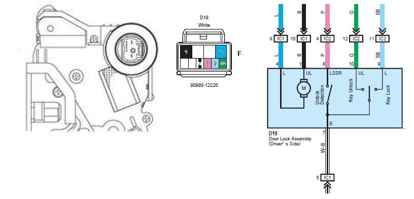

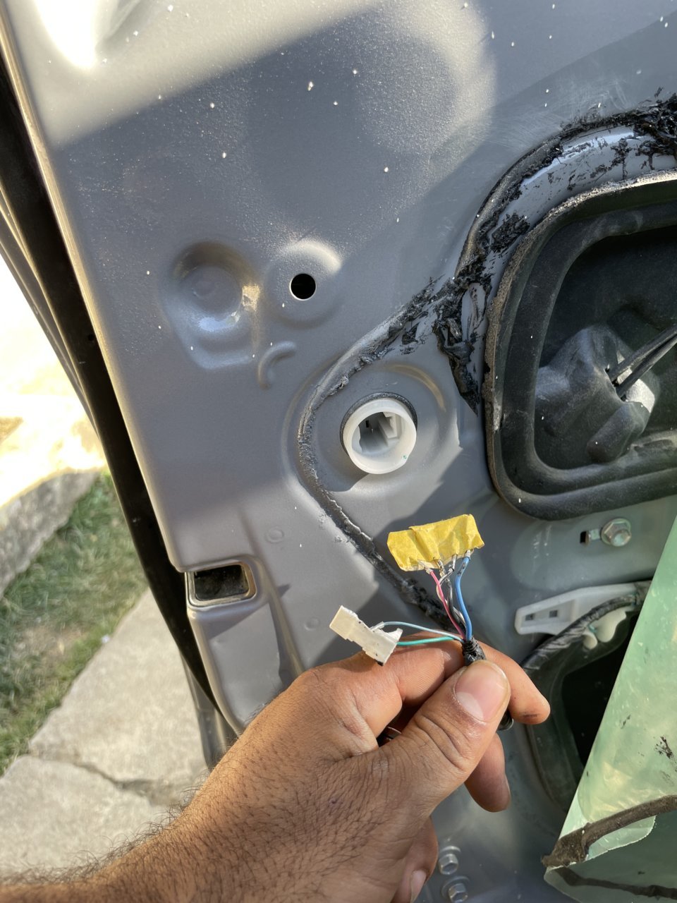

    Can someone send a photo of the connector, on the driver's door, mine broke and I must replace it with another, I need to see the color connection of the cables
    (2017 offroad)

    WTF did you do?

    That looks like the door control can high/low
    Pht-3167-98-00

    Sounded good to me....
    I will have to default to @caribe makaira he is the master at this stuff. I am pretty good at finding them, but I need something to match, and there isn’t a lot there to go off of. Also, @Empty_Lord is really good as well and might be able to help here.

    Beat me too it.
