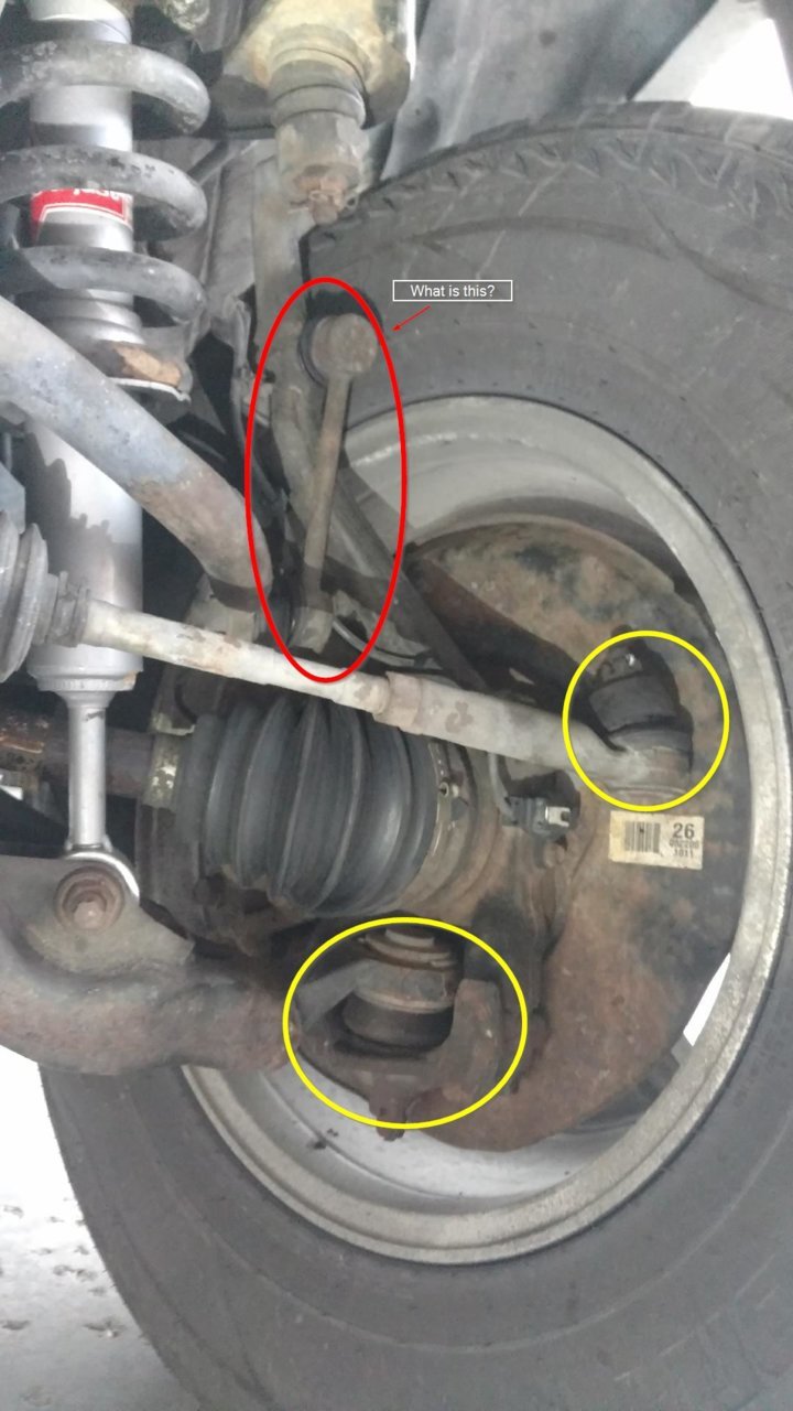

    In preparation to buy all the parts needed for this project I did some more inspecting of my joints and found that most had torn boots, ugh. So looks like I will be spending even more. One thing I could not figure out and can't seem to find as of yet is this red outlined part? What is it?

    I think that is your sway bar link. They make them with grease fittings too

    Red part is the sway bar link! Other two are the outer tie rod and lower ball joint.
