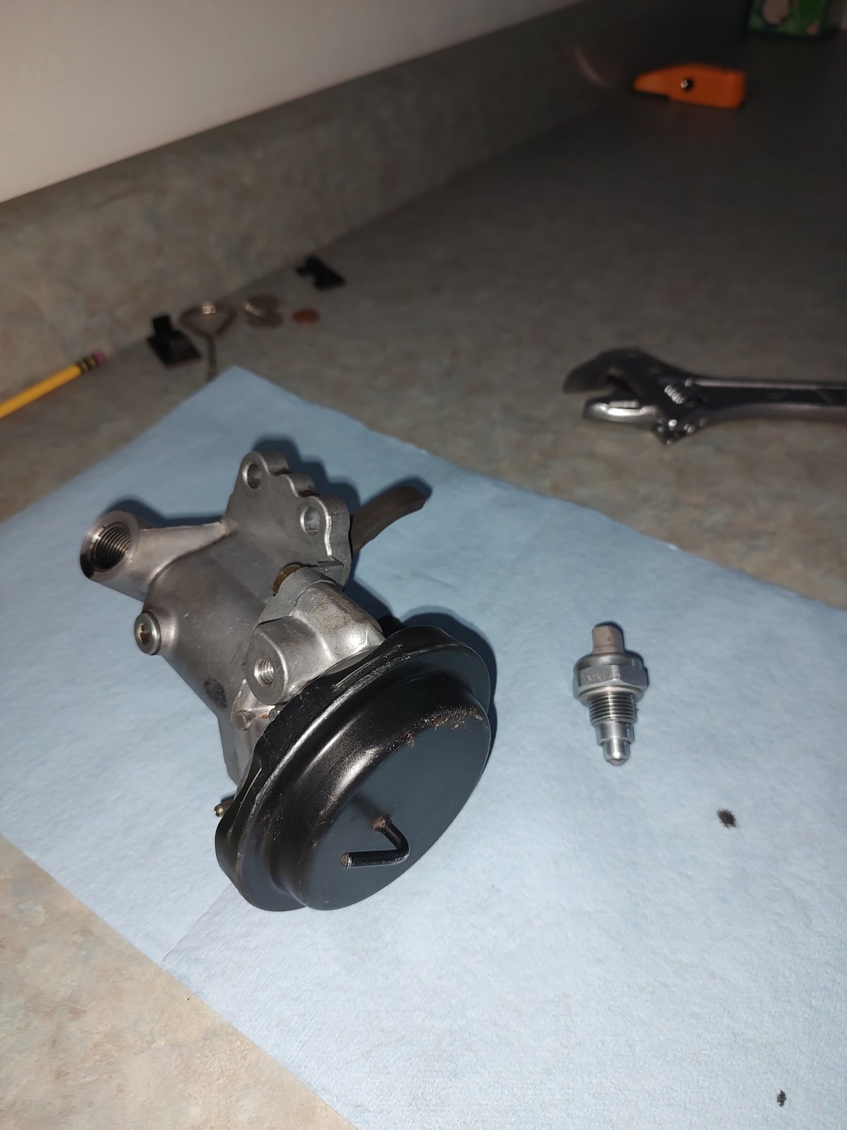

    Hello all. I've been trying to get my 4wd working on my '98 4runner Limited (apologies for posting in the first gen section, but I believe the ADD system is the same as 1st Gen Tacos. Also the smartest folks on TW have first gens :oldglory:).

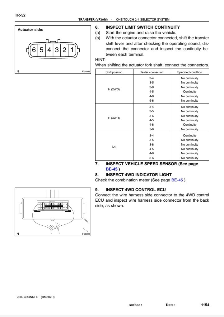

    I have confirmed that my transfer case engages and the front drive shaft spins in 4wd, but the 4wd dash indicator light never comes on and the front diff actuator doesn't engage. So I pulled the 4wd actuator off of the back of the front diff. I'm thinking I shouldn't have done that, and should've ruled out the ADD vacuum solenoids first. The actuator appears to be totally fine (fork moves freely, and nothing appears damaged).
    If someone has the FSM pages for how to test the Transfer Position Indicator Switch on the actuator with a multimeter, and could share, that'd be great.
    My next question is how should I orient the actuator upon reinstallation? The fork pivots up and down and slides left and right. Because of the struggle to remove it and jocky it out of the vehicle I have no clue how it was oriented when I pulled it out.

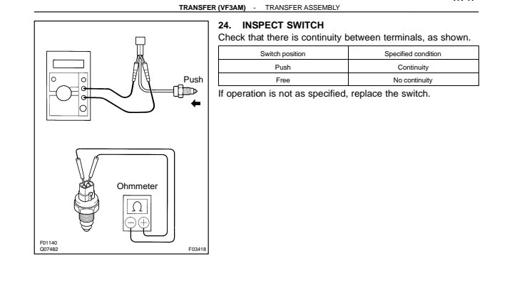

    So my Transfer Position Switch tested fine for continuity (thanks again @Strictlytoyz for that test info).
    So my replacement 4wd vacuum solenoids showed up today. So I resealed the actuator into the back of the front diff and replaced the solenoids. I can hear the solenoids clicking when I push the 4wd button (I didn't hear that before), so I think 4wd is fixed. Won't know for sure until I can fill the diff back up (waiting for the Permatex to cure first). Will update this tomorrow after I test that.

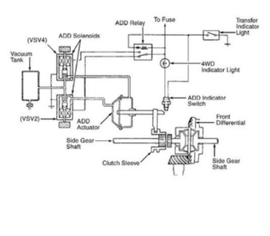

    If jacking up the truck gets you nowhere here's more troubleshooting for ya
    Screenshot_20231128_012320_Microsoft 365 (Office).jpg Screenshot_20231128_012328_Microsoft 365 (Office).jpg Screenshot_20231128_012336_Microsoft 365 (Office).jpg Screenshot_20231128_012345_Microsoft 365 (Office).jpg Screenshot_20231128_014230_Microsoft 365 (Office).jpg
    Assuming you have no vacuum leaks, if swapping your vacuum lines engages 4wd it's gonna be an electrical gremlin. I'll do more digging on testing the 4wd vacuum system

    Thank you for this @Strictlytoyz.
    I'm really hoping for a vacuum leak, and hoping to not have to go digging down the electrical gremlin rabbit hole. I'll start on these first thing tomorrow and report back.

    There should be two vsv's located on the inner driver fender area. A blue one and an orange one (VSV2/VSV4). Can't remember which one is 2wd and which one is 4wd. What you can do is pull one of the hoses off from either of those vsv's that goes down to the ADD actuator and start the truck. Place finger over nipple on vsv. If there is vacuum that is your 2wd vsv. If there is no vacuum, try placing truck into 4wd...could be your 4wd vsv. If you find it is your 2wd VSV, put that hose back, and pull the other. Shift into 4wd, put your finger over the nipple, and see if you have vacuum. If you get vacuum the vsv's are not your issue. If still no vacuum, and both the ADD switch and 4wd selector switches are working properly you have a bad vsv. Lastly, ensure the hose coming off the vacuum tank didn't get disconnected somehow. Here's a diagram of the vsv system.

    Excellent. That graphic really helps simplify the troubleshooting.
