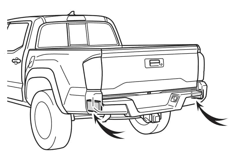

    So my blind spot monitoring does not work nor does the parking assist work. The automatic cruise control does work.
    Where are the exact location of the sensors on the front and rear bumpers?

    They're not standard on all trim levels. The parking sensors are the 2 black sensors on each side panel of the rear bumper, the BSM sensors are hidden behind those same panels near the corner of the bumper.
    The front does not have parking sensors on 3rd gen's, and the TSS module is located in the grille for the adaptive cruise and collision warning functions

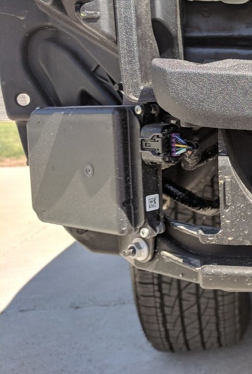

    If you get under the truck and look at the backside of the bumper, you might be able to see the BSM sensors. At most, you'll be able to confirm they're plugged in. Also, make sure no mud or debris is covering the plastic bumper caps, as the sensor can't see through obstructions.

    Did you happen to go through deep water when BSM stopped working? If so, try spraying contact cleaner on the BSM connectors, let it dry out and then drive around (maybe about 20 miles) with the message on the cluster saying BSM Not Available. That’s what I did and my BSM cleared itself up and has been working ever since.
    It is worth a try.
