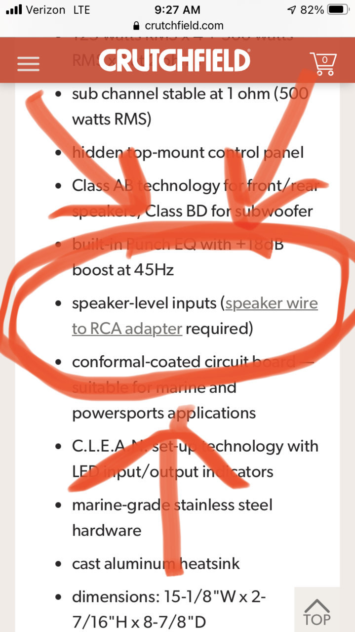

  13. Apr 30, 2021 at 6:30 AM
    dolbytone
    dolbytone Well-Known Member
    May 14, 2010
    #37165
    1,316
    South Carolina
    09 TRD Off Road
    Or he could get a T-Harness because...
    GRNT4R[QUOTED] likes this.
  14. Apr 30, 2021 at 6:39 AM
    GRNT4R
    GRNT4R Well-Known Member
    Feb 24, 2020
    #320266
    1,003
    NC - Triad
    2010 TRD Sport DCLB 4WD Silver
    TBD
    Bingo. There you go
