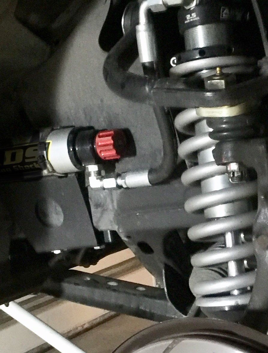

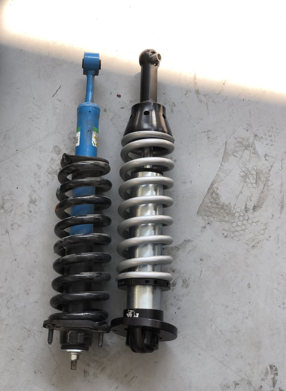

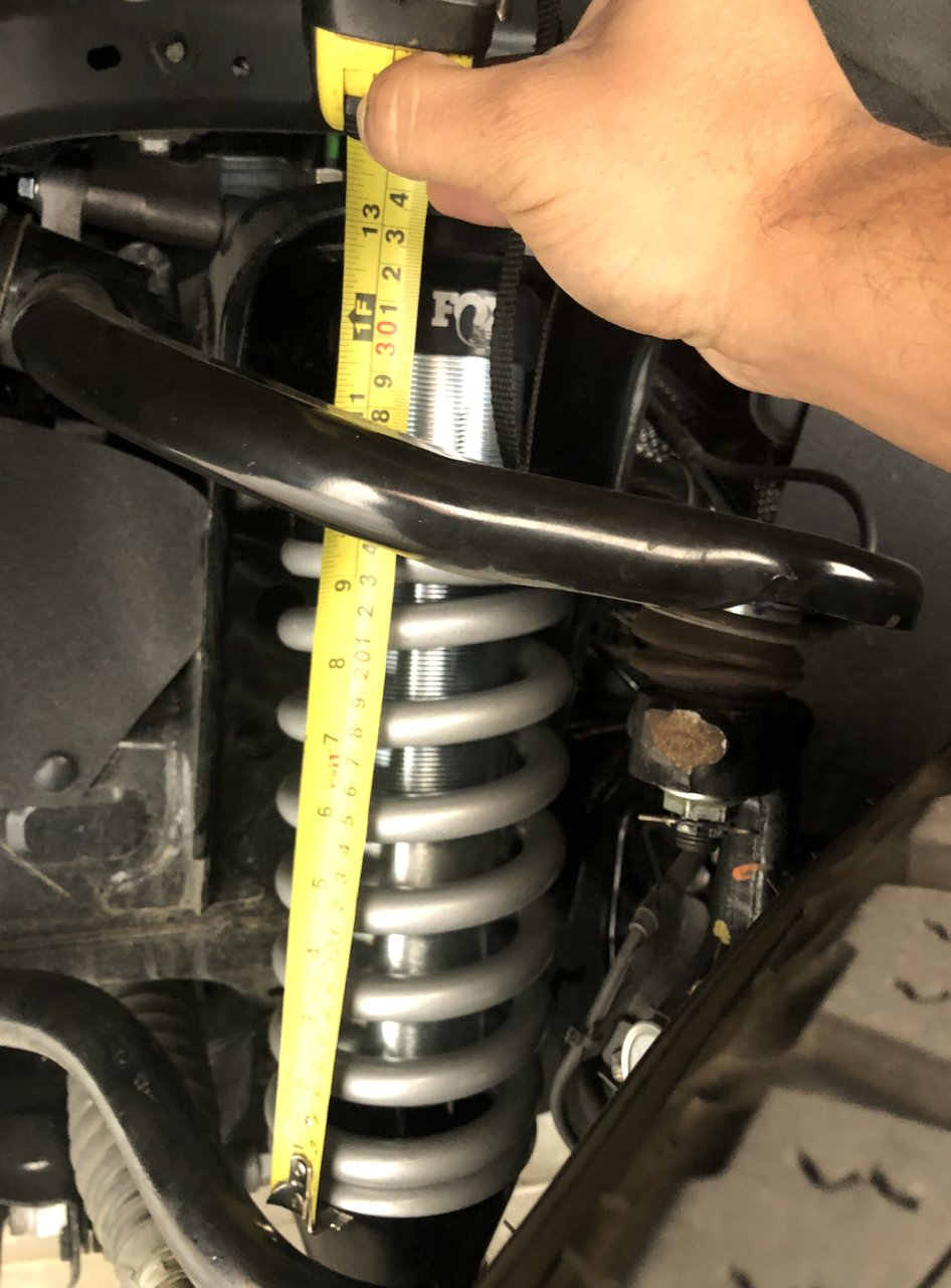

    hello, greetings from mexico, first let me excuse for my English are so bad, but I have a problem and hope you can help me
    i have a 19 tacoma and just installed fox 2.5 coilovers for a lift 2" but after installed I dont gain any lift, I adjust to max and makes no difference at all, I write to fox and tell me that is for skid plate, how need buy for can lift , I expend a lot of money in this and dont want use spacers
    thanks for read

    Like Ranger said,
    Get a longer spring, but don’t drop below 650# otherwise it will sag over time. 600# springs belong on 2nd gen trucks because they have a front end which is 300lbs lighter than the 3rd gen

    No 12". Those are 13" that come with the shocks.
    14" will fit.

    You have to use a 14"! A 12" is too short.
    The spring on the coilover is compressed. You need to use a spring compressor to take the old one off and put a new one on.
    I use a 14" 700lb spring, but I have a steel front bumper and full armor. This is the one I used: https://www.summitracing.com/parts/EIB-14003000700S

    Had 13” 600#’s. Not to great. When fox released these they were for the 2nd gen Tacomas. 3rd gen Tacomas are heavier. A few companies actually advise you to switch them out when you purchase them. Now I’m running eibach 14” 650#’s on my fox 2.5’s. Pretty solid. But may be adding a bumper so might have to jump up to 14” 700#’s
