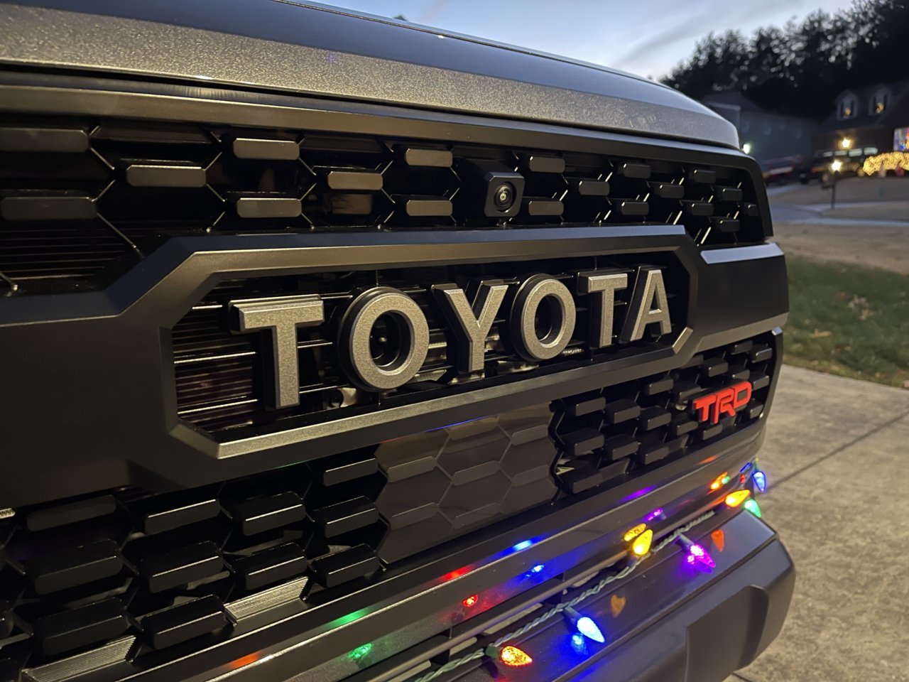

    I just installed an Anytime front camera system in my '20 SR5. Works great, and was not particularly difficult. I imagine retrofitting an OEM system will exceed the cost of the Anytime system.

    I have a 3D printed bracket for this grille and the 2020 TRD sport/OR grille too, I currently can fit two kinds of aftermarket cameras on it. If you want another style, you would have to ship me the camera. Would work with anytime or the germes lab setup as long as you used the style I have made for it which is a nakita box style or another cheaper version I bought to try for myself. I use the anytime setup cause I like the switch.
    Here is a link to the anytime setup that I use, you will have to search TW for the germes one.
    https://www.anytimebackupcamera.com/
