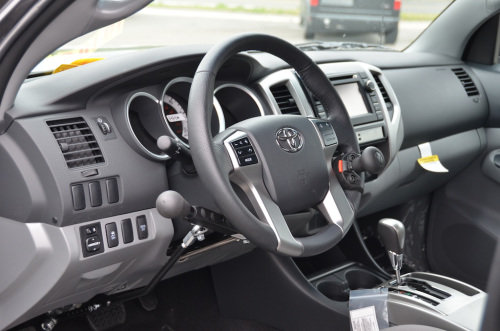

    Here's a Tacoma with professionally set up mobility controls.

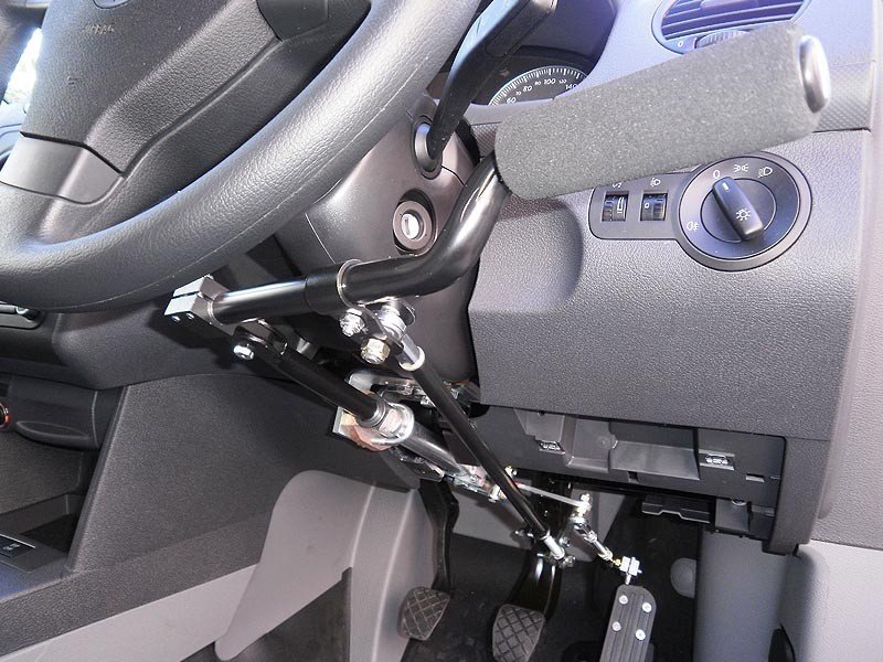

    Here's a different make/model vehicle that looks to have some quality/reliable mobility controls.

    My cousin has the same setup as this (more or less) in his chevy and has had it setup the same on his previous vehicles. I have driven with them a few times and feel confident with them. You can PM me if you want to and I'll try my best to answer any questions that you have.
