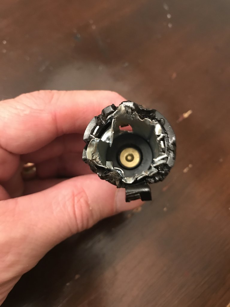

    Thanks..I did not want to take my dash apart just the HU out. I did get it out finally. It seems to have clips but they would not budge and my arms would barley fit in behind it through the HU hole, so I used needle nose pliers and kept crushing the sides in.
    Toughest part of the whole truck :Dimage.jpg

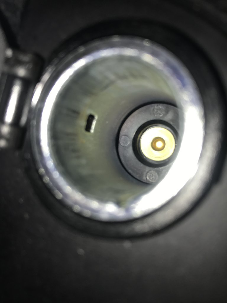

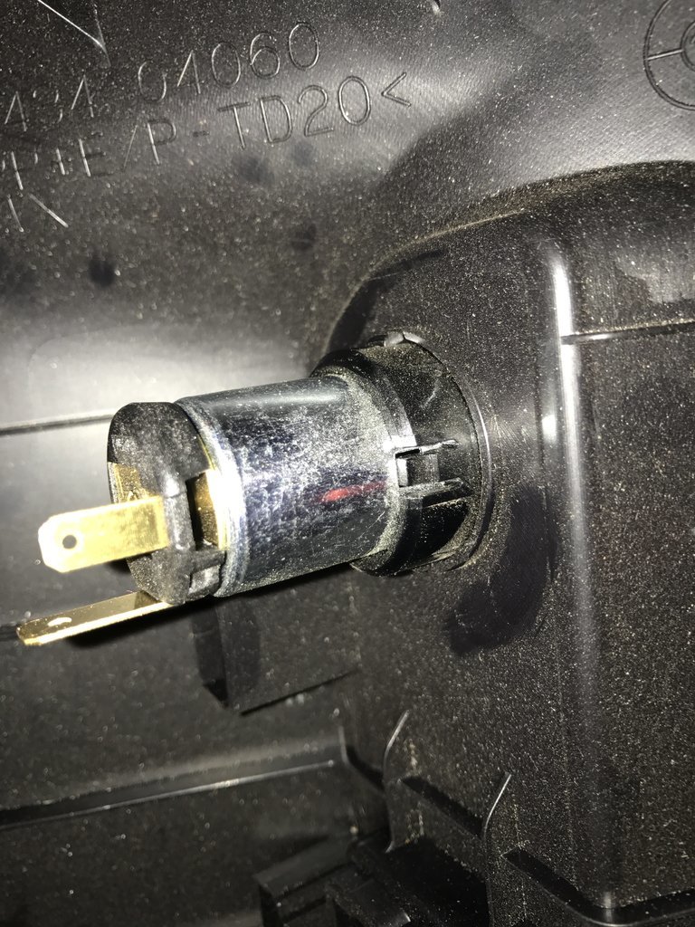

    Well i just looked at mine so heres some pics, it looks like there are two plastic tabs inside the outlet that need to be pushed out. Then a ring on the back side has 2 clips also that need to be squeezed once the outlet is removed.
